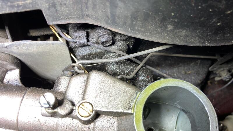

chipdumper 2 #8 Posted May 12, 2022 Ugh this thing look ugly. Lots of oil everywhere. 925 hours on the clock. Dipstick gasket is blown out. I had a tad too much oil in the sump (looks like it "self drained" any excess). That might explain the oil everywhere and the blue smoke. The breather interior was clean. I cleaned the crap off of the outside of the breather and even tested it and it seems to function as it should. The goofball I bought this off of said he replaced the carburetor assembly (CHICOM copy?) and its probably not adjusted properly. I'll try to follow the manual to tune that up properly when I get new gaskets for this. Share this post Link to post Share on other sites
