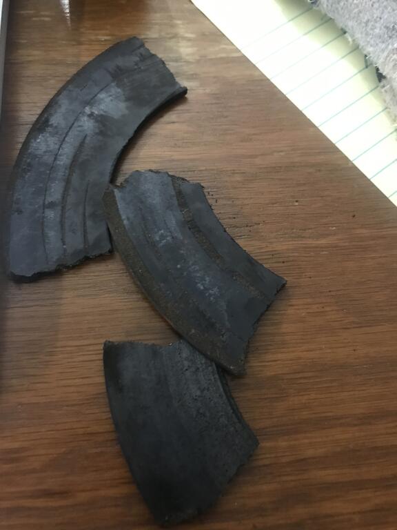

jellyghost 378 #1 Posted May 9, 2022 Hi. I hadn't run my C101 tractor in a while, and it started easily. While trying to engage the mower, I couldn't get the belt to properly drive the blades. After about a minute, this disc blew up off the belt power transfer. Can you tell me what this is, and where to get a new one? Any tips on replacement? Thanks! Share this post Link to post Share on other sites
squonk 44,125 #2 Posted May 9, 2022 You can buy the material and glue it on or buy a complete new one from Brian Replacement is simple. Disconnect the PTO lever rod at the top of the hoop. Remove the pin at the outer hoop/ PTO bearing pin. Swing hoop out of the way. Remove belt, slide off PTO pulley and remove 4 bolts holding disc on. 3 Share this post Link to post Share on other sites
Handy Don 14,268 #3 Posted May 9, 2022 From the images, it looks like there was no clutch lining left and the rivets were exposed. This might mean the PTO bell sustained some damage as well. A couple of pics when you have it apart will let the experts opine for you! 1 Share this post Link to post Share on other sites
jellyghost 378 #4 Posted May 9, 2022 Thank you. I will order one and look for damage when taking it apart. I will send some pics if there is anything suspicious. 1 Share this post Link to post Share on other sites
8ntruck 8,012 #5 Posted May 10, 2022 (edited) I got a disc last summer from my local Toro dealer for my 14-8. Was around $100. Edited May 10, 2022 by 8ntruck Share this post Link to post Share on other sites
