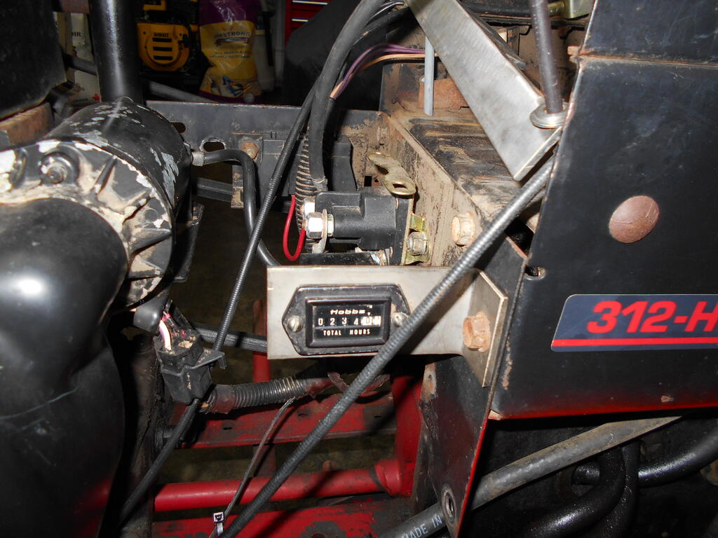

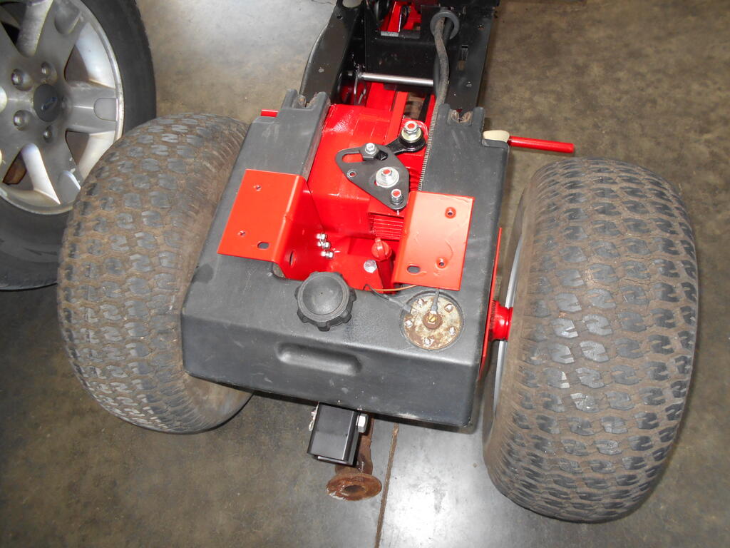

cleat 9,335 #36 Posted May 20, 2023 On 5/12/2022 at 5:39 PM, Horse Newbie said: I need a link to that hard-wired hour meter… That is my tractor. The bracket I just made from a scrap of stainless steel that I had lying around and the hour meter itself is a small panel mount unit that I believe I bought off of ebay. The OEM hour meter was removed so I could install a fuel gauge on the tractor from a 520 (it was not working properly anyways). Here it is being fitted prior to the machine being rebuilt. This is the fuel gauge and the tank with the sending unit. 2 1 Share this post Link to post Share on other sites
