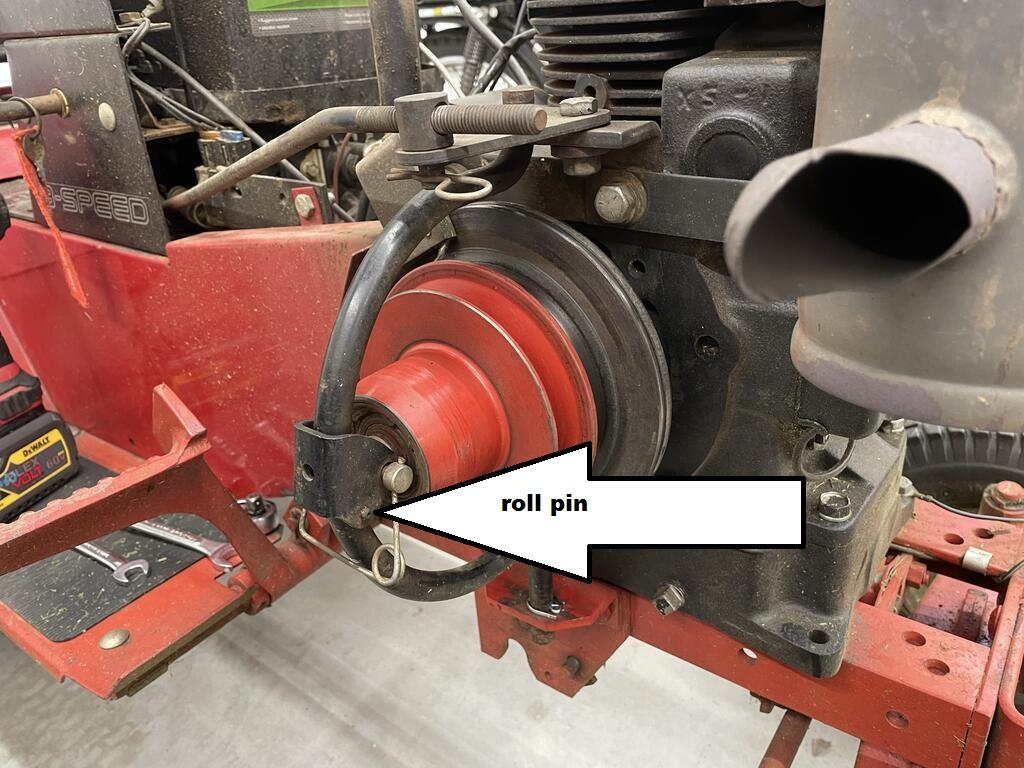

wallfish 20,219 #3 Posted May 4, 2022 Or the roll pin for the bracket broke, or... Post a close up pic of the PTO 1 Share this post Link to post Share on other sites

wallfish 20,219 #6 Posted May 5, 2022 Easier if you just post a pic of yours so we can actually see what's going on to try and help Or just pull the whole assembly apart and go through it all as you have the diagram. Look for any worn broken or missing parts Share this post Link to post Share on other sites
