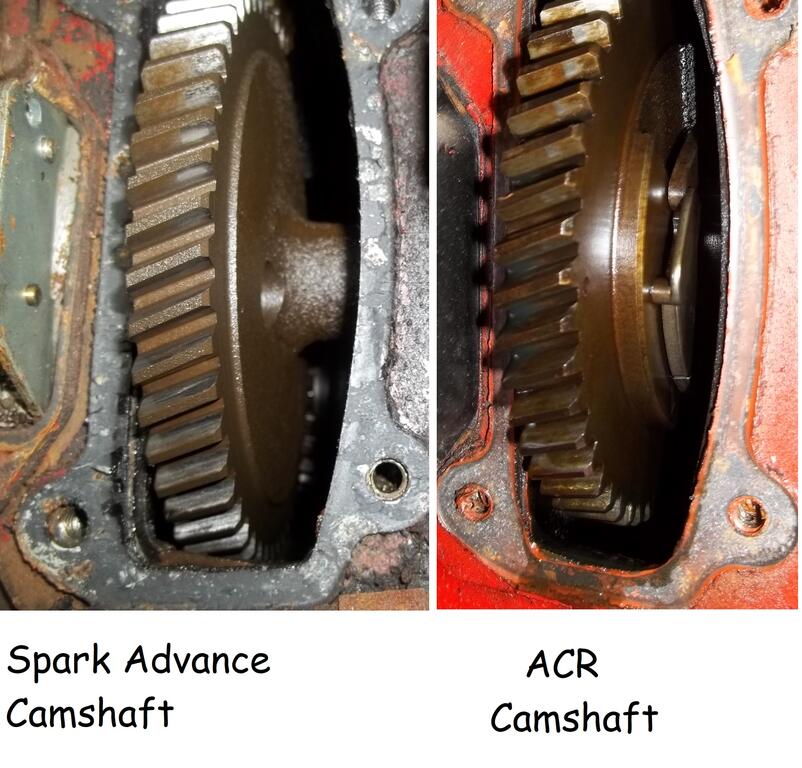

953 nut 62,180 #4 Posted May 2, 2022 My guess is that a spark advance cam is being used rather than a compression release. Perhaps the cam was reground for more valve lift or duration. Here is a write-up I did that explains it. I doubt that the cam timing is off or you wouldn't be able to idle it. Ignition timing on Kohler engines. Gapping the ignition points at .020 has always been the standard answer to how points should be set. That probably will get you into the ballpark where the engine will run, but with a bit of additional effort you can improve the engine’s power and performance. The Kohler engine manual in the Red Square files section covers two methods for setting the ignition timing, Static Timing and using a Timing Light. This manual is a relatively new manual and it overlooks the fact that many of our engines were built prior to the ACR (automatic compression release) camshaft. Earlier engines (mostly 1965 and earlier) had a Spark Advance camshaft that can not be timed using Static timing. At rest (and very low RPMs) the timing is retarded to fire slightly after TDC. The timing mark (SP) on your flywheel is at twenty degrees before top dead center but at rest the points on these engines break about ten degrees after top dead center. The only reliable way to check or set the timing on these engines is with a timing light. There are a couple ways to determine what camshaft you have. Presuming the camshaft in your engine is the one it was born with the data plate on the engine has a suffix that can tell you what camshaft was used. The table below will tell you the suffix applicable to your engine. The other way to determine what camshaft you have is to remove the cam gear cover and take a look. If you see a mechanism attached to the cam gear it is the ACR cam. The following engines have the spark advance camshaft; K-141, Suffix prior to “C” K-161, Suffix prior to “J” K-181, Suffix prior to “D” K-241, Suffix prior to “D” 4 3 Share this post Link to post Share on other sites

953 nut 62,180 #7 Posted May 3, 2022 12 hours ago, JoeM said: I don't have the original cover or spec. That is what the pictures are for. pull the cam gear cover and take a look to see what type camshaft you have. 19 minutes ago, Ed Stoller said: "where the points are fully open and that mark it not even close to the flywheel timing marks." The spark fires when the points just open electrically not when they are fully open. Ed Rolling the flywheel over in the clockwise direction while watching the points you should find that the points open near TDC. If you have the ACR cam it will occur at twenty degrees before TDC, with a Spark Advance cam it will be about ten degrees after TDC. Setting your points also sets your ignition timing. With a battery ignition system, the ignition points are closed the majority of the time. With the points closed and the ignition switch ON the primary windings of the ignition coil have current flowing through them and are developing a magnetic field in the iron core of the ignition coil. The moment the ignition points open the magnetic field collapses and induces a momentary high voltage pulse in the secondary windings of the coil which goes through the spark plug wire and arcs across the gap of the spark plug. If this occurs in the presence of a compressed fuel/air mixture of the proper ratio an explosion will occur within the cylinder. If this explosion occurs at the proper time in the engine’s cycle there will be pressure applied to the piston forcing it downward on the power stroke. The ignition points will continue to open further after this has occurred. How far they open is immaterial, their work has been done for that cycle of engine operation. What is important is when they open relative to the position of the piston on its compression/power revolution. If it occurs too soon there will be backfiring, too late and there will be a reduction of power. In the case of our Kohler engines the sweet spot is twenty degrees Before Top Dead Center, that is what the “SP” mark on the flywheel is set. At the moment the points open the condenser quenches the arc across the points extending their life, the rest of the time it just sits there. Static timing can be done with Kohler engines that do not have a Spark Advance camshaft. The instructions in the Kohler Engine Service Manual for static timing of the later ACR camshaft engines calls for an Ohm Meter to be used. I prefer a 12 Volt Test Light. The light will be connected between the battery “+” terminal and the lead that connects the points to the coil (disconnected from the coil). When the points are closed the light will be on, the moment the points open the light will go off. You don’t have to be focused on it like you would on a meter. With the test light situated near the sight hole for the flywheel (spark plug out so the engine will turn with ease), turn the flywheel slowly by hand in the clockwise direction (counter-clockwise if on the PTO end) until the moment the light goes out. If the “SP” mark is centered in the hole you are done, if not you have a little work to do. If the points are opening too late, they need to be opened further, if it occurs too early they need to be closed up some. Make gradual adjustments until the “SP” mark on the flywheel is centered in the sight hole at the moment the light goes out. Now tighten the screw securely and turn the engine over several revolutions to be sure the points are consistently opening at the proper moment. 3 Share this post Link to post Share on other sites
