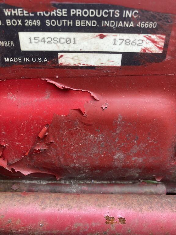

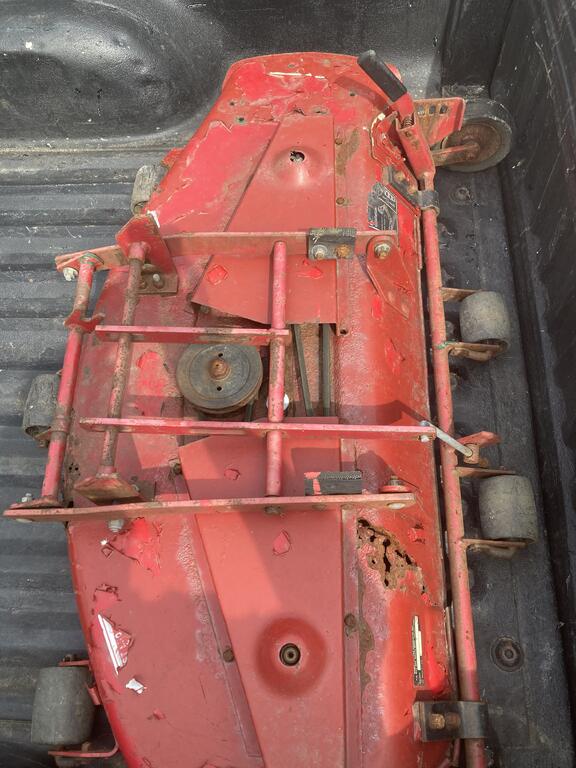

Handy Don 14,713 #6 Posted May 2, 2022 58 minutes ago, Eric swanson said: My deck is 38” cut.it already has the deck belts,I need the drive belt from the tractor to the deck.I need to know that size belt Finding the deck info sticker and posting the model and serial number would be a great help. Otherwise, a couple of clear pictures of the full deck. Quite a few decks out there with a variety of drive belt sizes. We don't want to steer you wrong. Share this post Link to post Share on other sites
gwest_ca-(File Mod) 11,753 #7 Posted May 2, 2022 Off to a bad start here. They did not make a 38" deck for the C-Series tractors. 37" 2-blade - If you already have a spindle belt it is not this one. 36" 3-blade rear discharge 36" 3-blade side discharge 42" 3-blade rear discharge 42" 3-blade side discharge 48" 3-blade side discharge. It makes a difference to the drive belt required. 1 Share this post Link to post Share on other sites

gwest_ca-(File Mod) 11,753 #9 Posted May 2, 2022 Better try your other eyeball. Click on the fuzzy picture in the link. The belts used will come up on the next page. Share this post Link to post Share on other sites
gwest_ca-(File Mod) 11,753 #10 Posted May 3, 2022 There are only 2 belts on this deck. Mower Drive belt #102742 replaced by 94-2501 (1/2" x 103") Mower Spindle belt #6738 - 1/2" x 86" 1 Share this post Link to post Share on other sites
