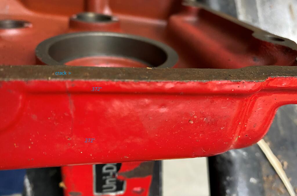

lynnmor 9,010 #27 Posted April 29, 2022 13 hours ago, JoeM said: What you think Lynn 3/8 5/16” The case measures .372" at the gasket surface, then drops to .272" thick. 1 Share this post Link to post Share on other sites
