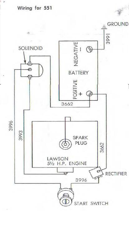

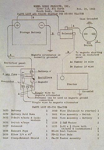

953 nut 64,649 #4 Posted April 20, 2022 Your engine has a magnito so there is no electrical connection to the ignition system. Someone who ownes one may be able to add a picture of the 551 Ignition shut off system consists of a wire from the (choke handle I think) that will contact the top of the spark plug to short it to ground. Here is a drawing of the electrical system. There are two diodes and a fuse in the item labled rectifier, don't get them mixed up. Wires 3991, 3993 and 3662 will be six guage wires. All other wires can be sixteen guage. 2 Share this post Link to post Share on other sites

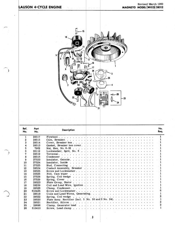

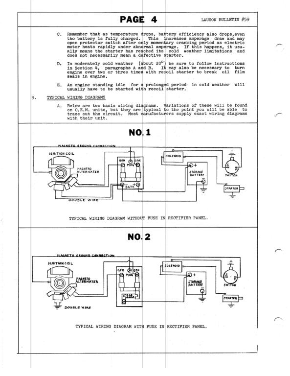

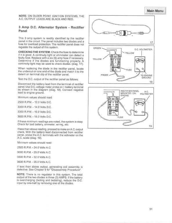

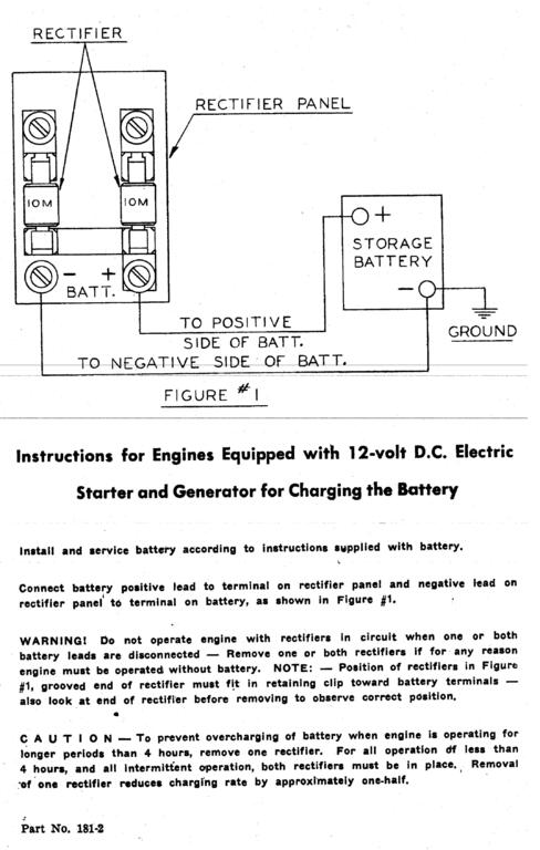

formariz 12,358 #5 Posted April 21, 2022 Before you start tinkering with the electrical part of that engine, study the attached information. That engine's electronics is a bit unconventional. Many engines have been rendered useless by unaware owners. Parts for it are as hard to find as hen's teeth. Switch and solenoid are unique to that engine, and operated through grounds and not power. 2 Share this post Link to post Share on other sites
