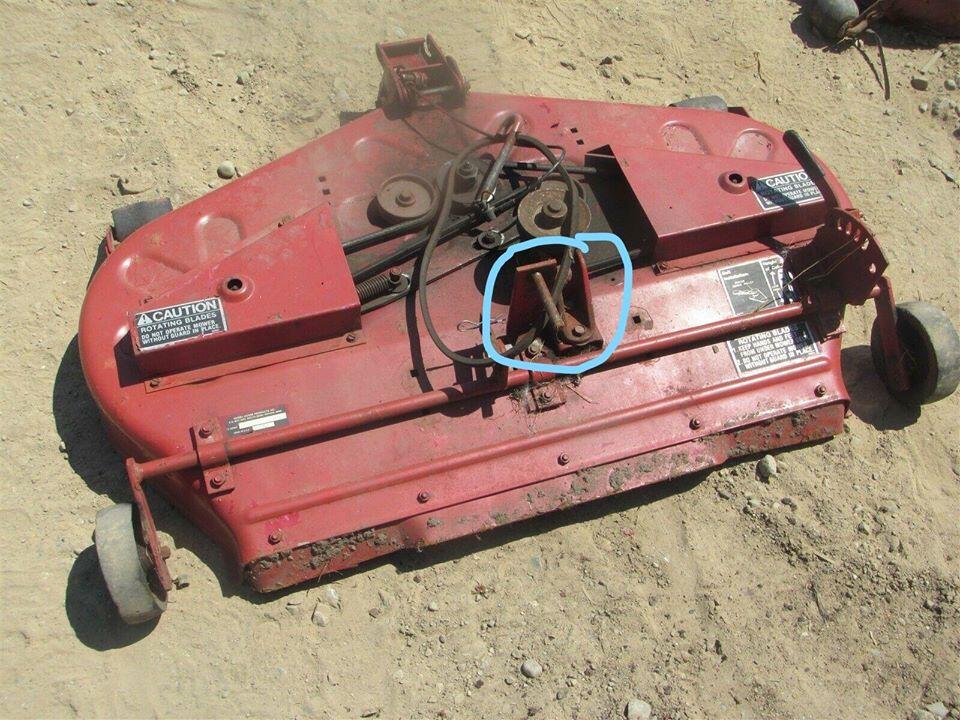

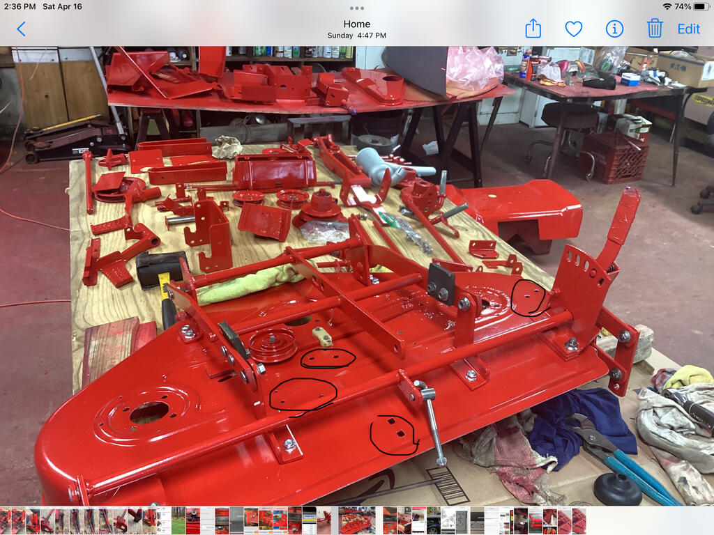

41chevy 74 #1 Posted April 16, 2022 Can someone tell me what goes in the circled holes? Thx 1 Share this post Link to post Share on other sites

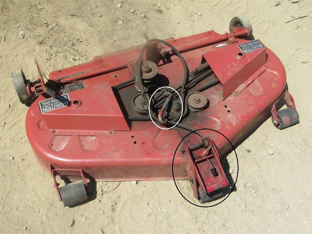

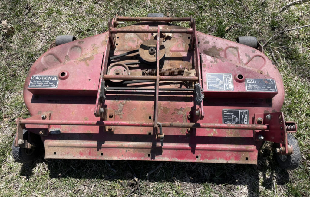

squonk 45,620 #2 Posted April 16, 2022 Hope this helps. lifted off of FB 1 Share this post Link to post Share on other sites
41chevy 74 #3 Posted April 16, 2022 Thanks, that lift mechanism is different then mine. Your pic shows extra holes like mine but what would they be for? 1 Share this post Link to post Share on other sites
WHX?? 55,262 #4 Posted April 16, 2022 Does the IPL show anything going in them? 1 Share this post Link to post Share on other sites
41chevy 74 #5 Posted April 17, 2022 I just found a manual for my deck on e-bay and purchased it. My tag reads 65-36xro1. I’ve looked through Red Square and can’t find IPL diagram of my deck I found the spindles and that’s all. 1 Share this post Link to post Share on other sites

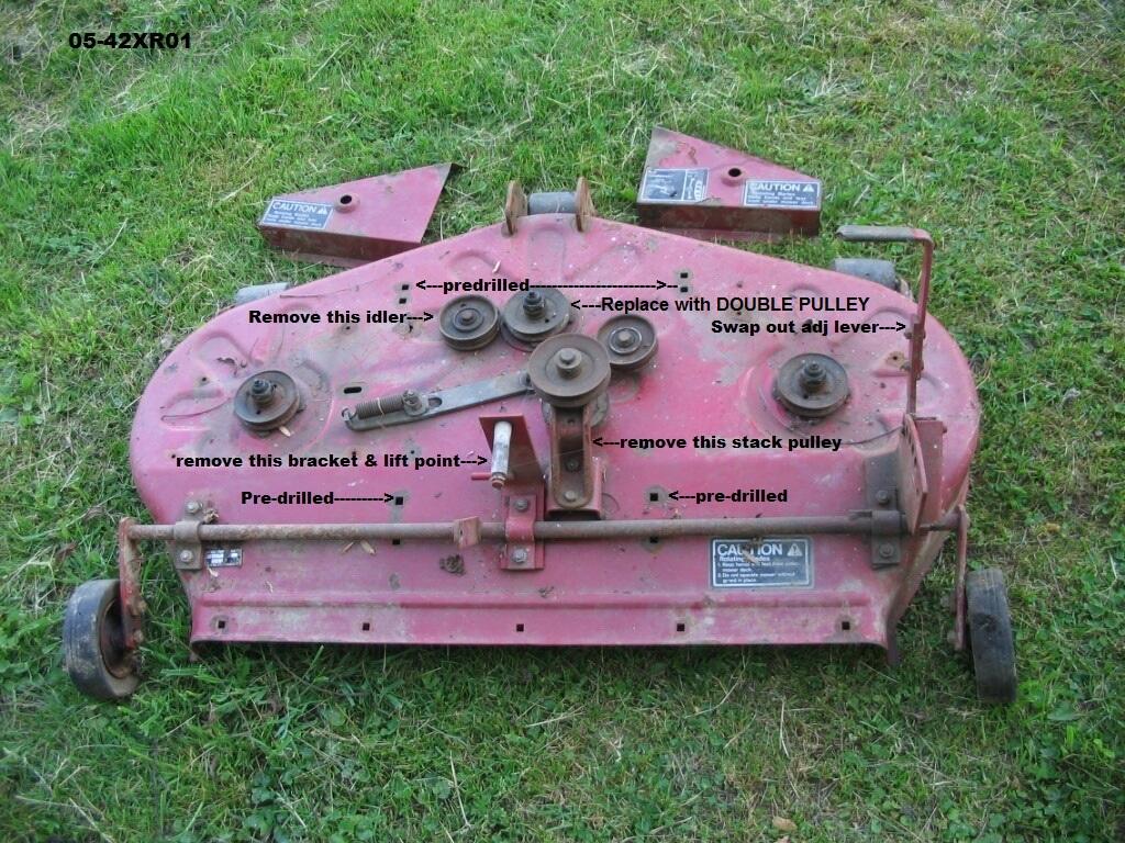

Jennifer 1,878 #6 Posted April 17, 2022 (edited) I posted this for sale so pictures were handy so I added here but I can decide if they are the same deck.. I see close to the sack discharge area this one has the two holes but don’t notice the others? 🤷🏻♀️ Hope it’s of some help…. The bottom side it seems like there are holes… I can look better tomorrow if you like…. Maybe they used the same shell with different hangers so they are just extra! Edited April 17, 2022 by Jennifer 1 Share this post Link to post Share on other sites

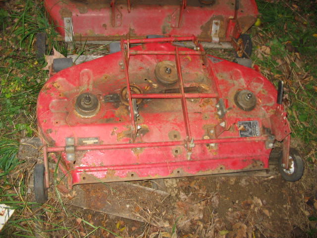

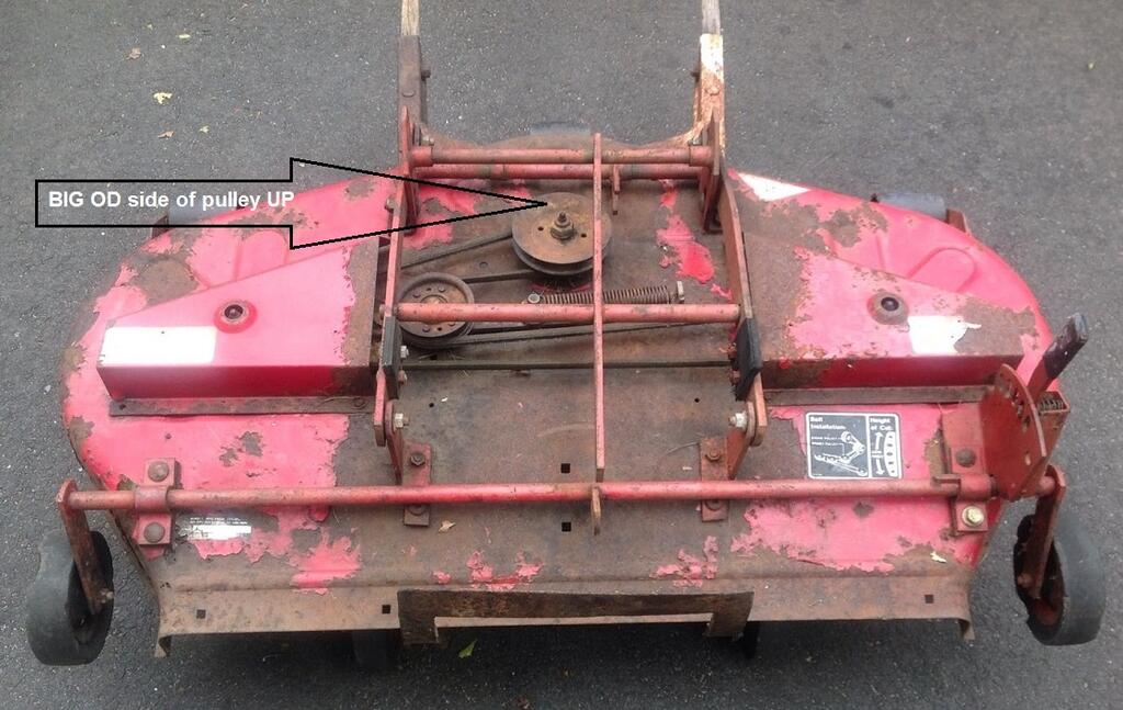

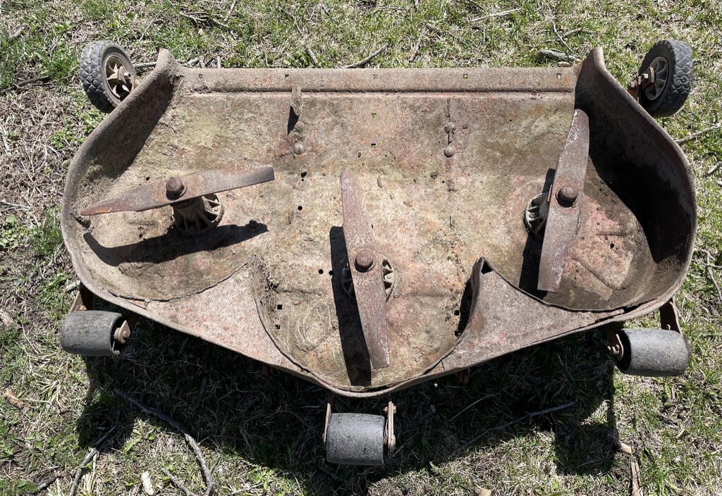

daveoman1966 3,882 #9 Posted April 17, 2022 The deck 'shell' is stamped out for several models with various lift mechanisms and drive pulley setups...some for vertical shaft engine tractors (1st 3 pics) , some for horizontal shaft (last 2). 3 1 Share this post Link to post Share on other sites

41chevy 74 #12 Posted April 17, 2022 7 hours ago, daveoman1966 said: The deck 'shell' is stamped out for several models with various lift mechanisms and drive pulley setups...some for vertical shaft engine tractors (1st 3 pics) , some for horizontal shaft (last 2). Thx Dave that makes sense. 1 Share this post Link to post Share on other sites
clueless 3,348 #13 Posted April 17, 2022 I think Dave nailed it. 1 Share this post Link to post Share on other sites
