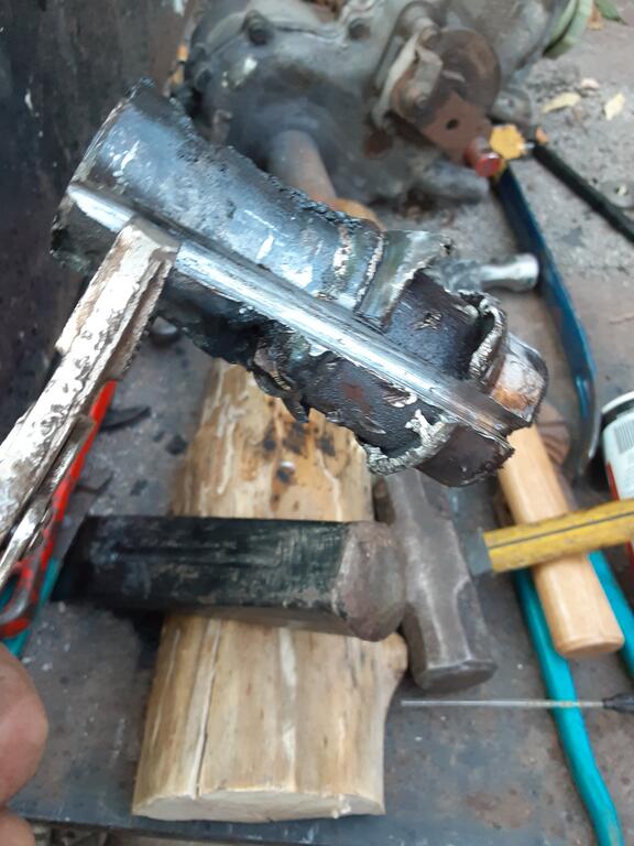

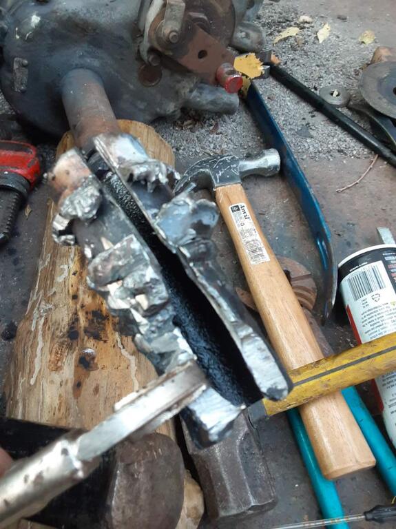

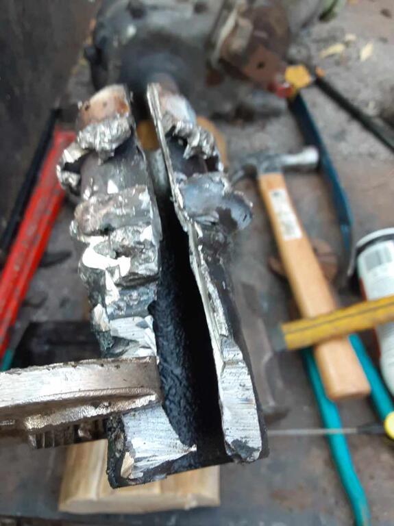

BBQVultureWings 160 #5 Posted October 13, 2024 On 4/16/2022 at 7:08 AM, ri702bill said: @Maxwell-8 That is the same mindset that replaces the soft shear pins on walk behind snowblowers with Grade 8 hardened bolts because they think it is a better fix... until they break the gearbox... Bill It is shocking to see what some people thiMk is a great idea. Sometimes it's fun to watch. Usually it's frightening ..... Here is a case of Neglect, I had to destroy the rim to get this off the axle: 2 Share this post Link to post Share on other sites
