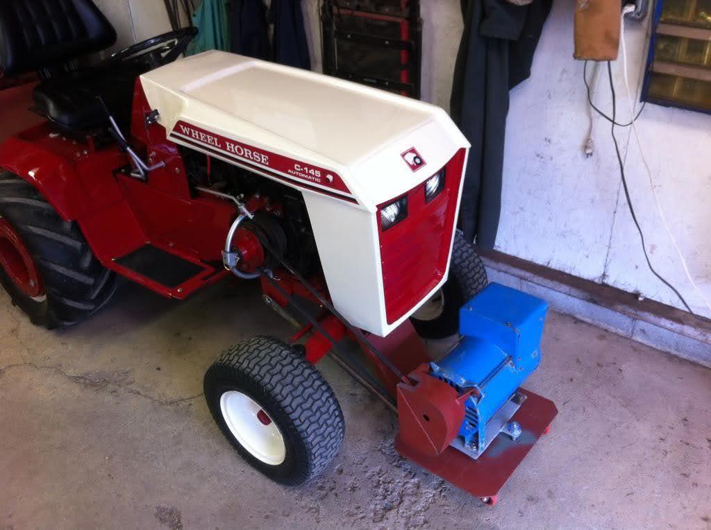

squonk 45,625 #7 Posted April 13, 2022 On Marvin with the single stage the belt just missed the side of the hood. I don't have a picture on the right side with a blower but you can see how close the belt is on a genny set up. 1 Share this post Link to post Share on other sites
