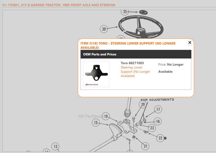

rhulette 0 #1 Posted April 9, 2022 So, for this season, I decided that it was time to replace the front flange steering bearing. All was going well until I took out the 2 bolts on the lower steering support. To my surprise, one of the ears had snapped off some time ago. This machine was a hand me down from 2 BILs who were not so kind to it, including one who accidentally drove it into a tree. I suspect that's where the trauma occurred, but it's been bolted down tight and working fine. Can someone recommend a parts guy who would have one or anyone have one sitting on the shelf? I can still get the brass bushing for it, so that's not a problem. Thanks! Randy Share this post Link to post Share on other sites
squonk 45,490 #2 Posted April 9, 2022 They break all the time. I keep a spare on hand. Try A-Z tractor https://a-ztractor.com/ 1 Share this post Link to post Share on other sites
roadapples 6,987 #3 Posted April 9, 2022 K&B horse parts in the vendors section has them...and 2 Share this post Link to post Share on other sites

Lee1977 7,551 #7 Posted April 10, 2022 They can be fixed. Share this post Link to post Share on other sites
