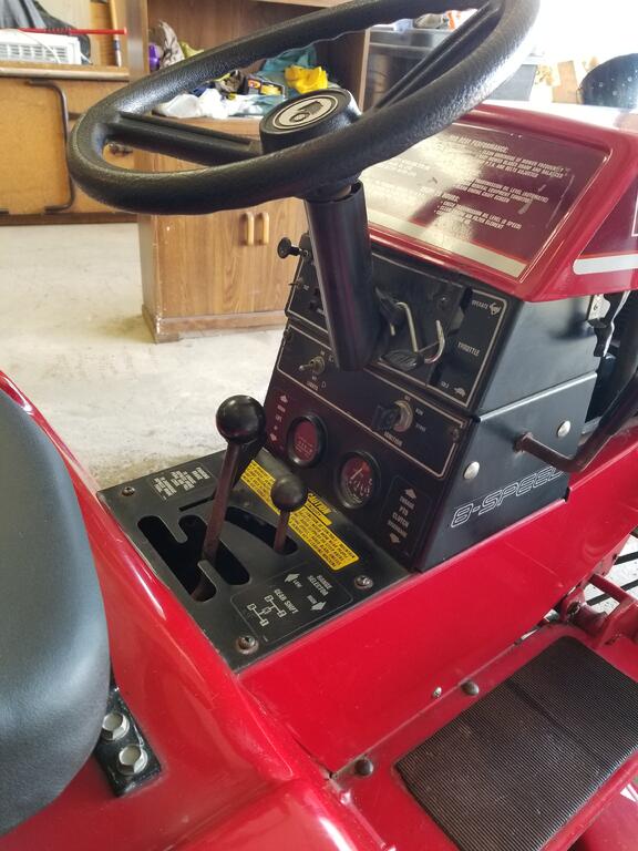

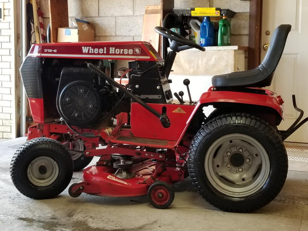

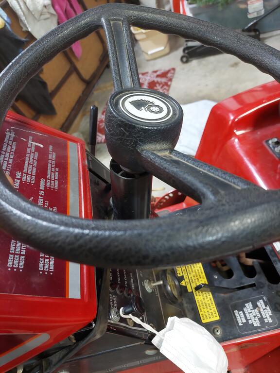

sodapop 2 #11 Posted April 9, 2022 (edited) Here is a couple pics.of my 1986 312-8 ,,,it has never sat outside, always garage kept ,no rust any where... Edited April 9, 2022 by sodapop 1 Share this post Link to post Share on other sites
johnnymag3 2,633 #12 Posted April 9, 2022 Looks like you may need a new tube also........Nice looking 312 !!! Share this post Link to post Share on other sites
SylvanLakeWH 29,871 #13 Posted April 9, 2022 Looks bent. Is it “broke” as well? As in, does not function? If just bent, I’m thinking it could be bent back…? Share this post Link to post Share on other sites
sodapop 2 #14 Posted April 9, 2022 It still works, I can use it, but it's like half of it is real loose, the other half is stiff, it must have broke inside the plastic, there must be metal inside or something.. Share this post Link to post Share on other sites
Handy Don 15,215 #15 Posted April 9, 2022 (edited) Yep 53 minutes ago, sodapop said: ...it must have broke inside the plastic, Yep, plastic molded around metal. Likely the inner bar is broken on one side. Check in our vendor section. At least a couple of them are likely able to fix you up with a new one. Also, search for some of the old threads that discuss removing these steering wheels--they use a roll pin and if they are rusted...well, they can be tough to remove! Edited April 9, 2022 by Handy Don 1 Share this post Link to post Share on other sites
Bill D 2,442 #16 Posted April 9, 2022 Take the center cap off and start soaking the shaft and spiral pin with penetrating oil. Consider installing a 15", 3 spoke wheel from a 417 if you can get one. I like the feel of the larger wheel and it makes steering easier. 1 1 Share this post Link to post Share on other sites
johnnymag3 2,633 #17 Posted April 9, 2022 (edited) If its that bad......just cut the center and remove it....then the pin will be easy to deal with. I have a wheel if you want to buy one. There are a few on Stealbay also. Bill D has a way to make new tubes also....the part under the steering wheel Edited April 9, 2022 by johnnymag3 1 Share this post Link to post Share on other sites
