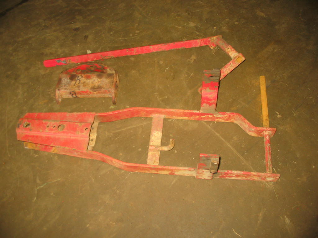

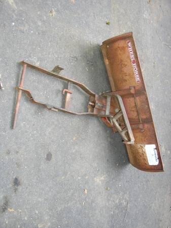

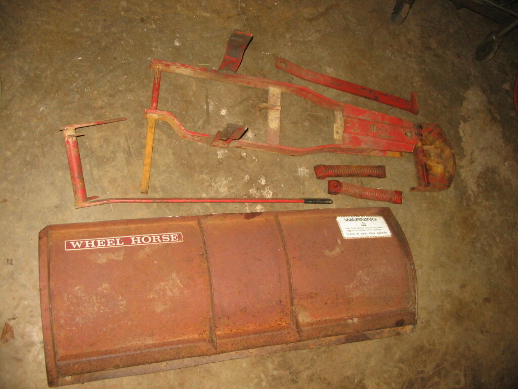

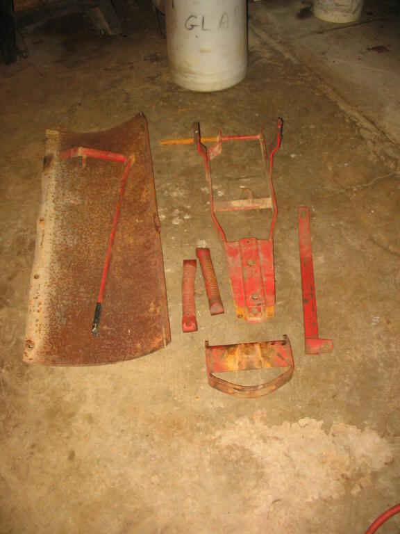

Dave 1953 70 #1 Posted April 7, 2022 A local guy has a 42" dozer blade with this p/n on it but he doesn't know which models it fits and I have searched the web and can't find out anything. Does anyone know what it fits? I have a GT14 and thought I might buy it if it fits mine. Thanks. Share this post Link to post Share on other sites
daveoman1966 3,882 #2 Posted April 7, 2022 That model 766-42BA01 is for the A-90 orA-100 tractor/mower. I have one like it...you are missing some hardware though. The 'plow' will fit most other wheelhorse Dozer blades...but the mounting is for the 'A' series. 1 Share this post Link to post Share on other sites
Dave 1953 70 #3 Posted April 7, 2022 Thank you so much for the info. I will pass it on to the seller but the most important thing is it won't fit my GT14. Share this post Link to post Share on other sites
