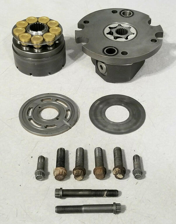

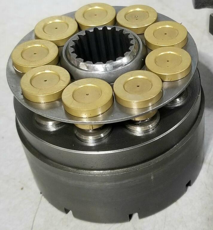

"Manic-Mechanic" 1,485 #1 Posted April 5, 2022 (edited) I have an opportunity to buy these for 75 bucks, thinking might be a good grab? Edited April 5, 2022 by "Manic-Mechanic" 1 Share this post Link to post Share on other sites

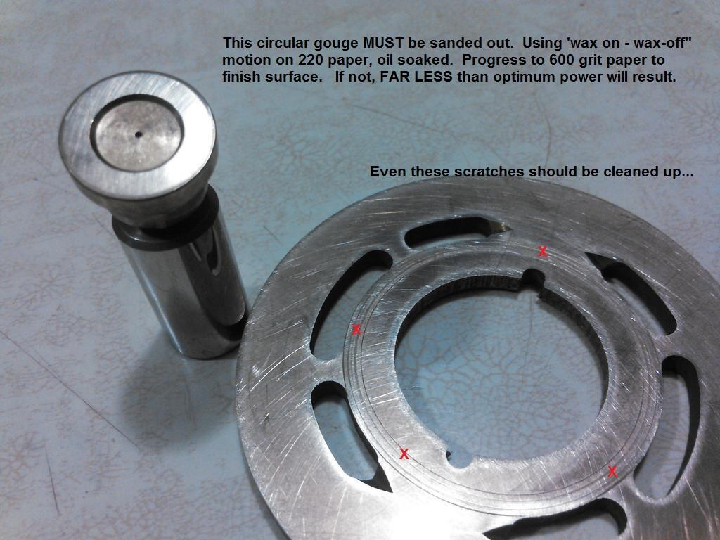

daveoman1966 3,882 #2 Posted April 5, 2022 From pics, parts look to be in fair condition. You'll probably need to refinish metal-to-metal contact points to ensure good operation. Use 600 or 1000 grit sandpaper on a surface plate (or thick glass) with a few drops of oil...removing just enough material to eliminate visible scratches/gouges. 1 Share this post Link to post Share on other sites

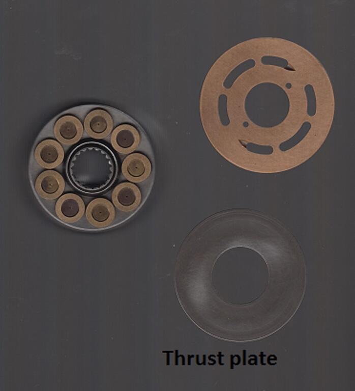

"Manic-Mechanic" 1,485 #3 Posted April 5, 2022 (edited) Excellent instructional! The slippers, is it super critical that they be kept exactly in the same spot in the Cylinder Block as stated in the manual? Has it to do with the little piston sleeves as well as the slipper positioning on the Thrust plate? In the set of used components the seller couldn't say for sure if all 9 were kept as situated before disassembly....Also the Motor Valve Plate in picture, it has deep recesses right? If I wet sand it smooth couldn't reach an out of tolerance, become too thin? 75 good price for those or a gamble? I will copy this instructional if that's ok? Edited April 5, 2022 by "Manic-Mechanic" Share this post Link to post Share on other sites

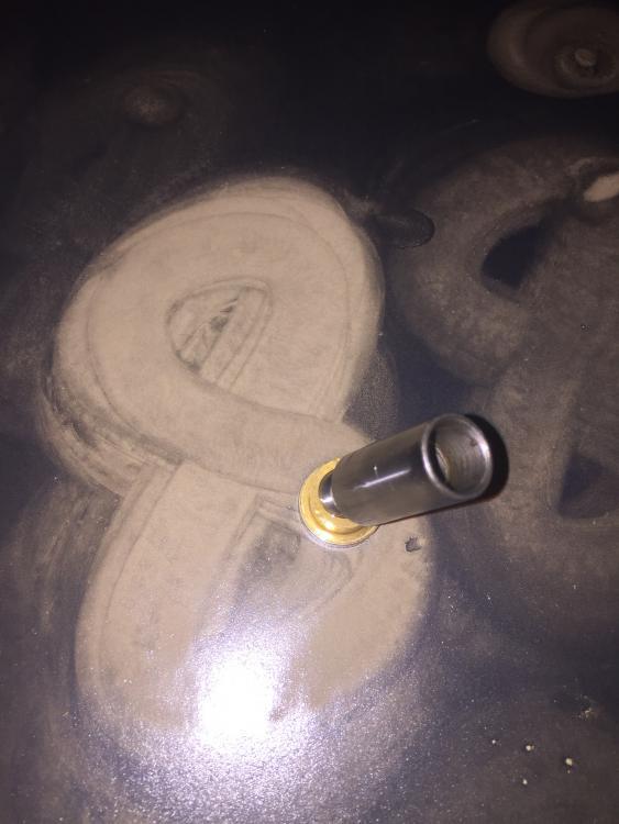

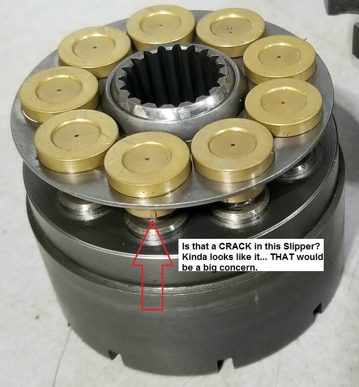

daveoman1966 3,882 #8 Posted April 6, 2022 This is your pic.. Is that a CRACK in the Piston Slipper? I'd be concerned if it is... If it is CRACKED, I have a replacement for it. Share this post Link to post Share on other sites
"Manic-Mechanic" 1,485 #9 Posted April 6, 2022 Not sure, next one over has one too, if cracked or casting? (are thy cast brass?) This is the one for sale, not from my unit. Very nice of you too mention it tho' and offer replacement. Share this post Link to post Share on other sites
daveoman1966 3,882 #10 Posted April 6, 2022 The four spares PISTON & SLIPPERS that I have are for Sundstrand 90-2046 or 90-2062...they are BIGGER than yours and won't work for you. Nonetheless, they are NOT cracked...not at all. They are cast BRASS slippers, crushed onto a BALL joint on the end of the steel piston. They may last a long time with that crack, but unlikely. Share this post Link to post Share on other sites
