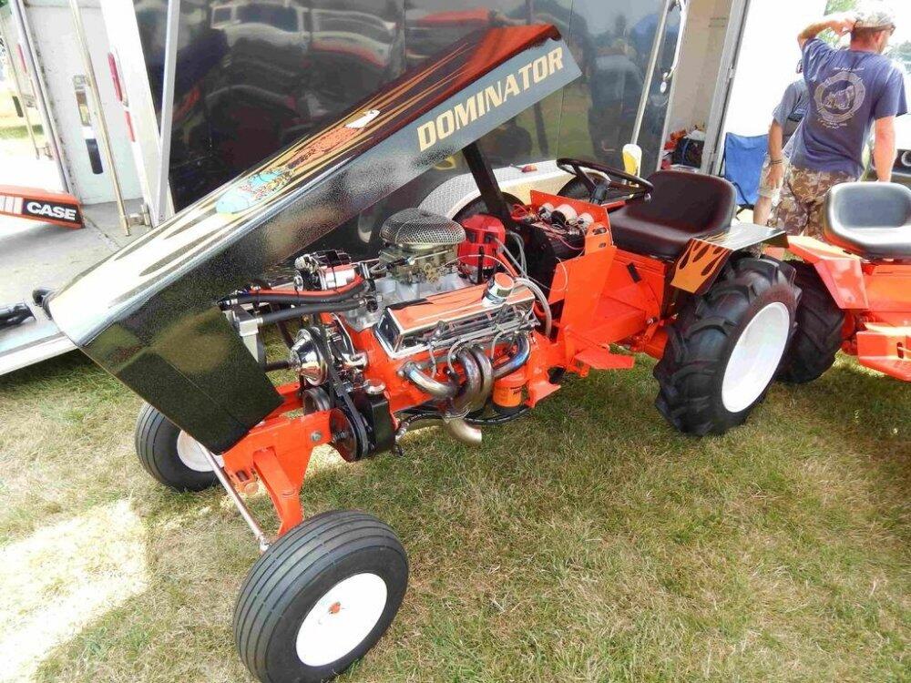

Wild Bill 633 938 #28 Posted April 9, 2022 The SBC powered Case tractor pictured was very impressive until I laid on the ground to see how the power was transmitted to the rear axle, What i saw was no bell housing cover and absolutely nothing connected to the rear of the crankshaft. Made me scratch my head. I then noticed the long hydraulic lines between the power steering pump and the hydraulic motor on the transaxle. 2 2 1 Share this post Link to post Share on other sites
sjoemie himself 3,178 #29 Posted April 10, 2022 23 hours ago, Bill633 said: power steering pump and the hydraulic motor on the transaxle. That's pretty clever, I like it! That being said I can't imagine that delivers much power to the axle? Probably enough for driving around but not for serious pulling 2 Share this post Link to post Share on other sites
ebinmaine 80,461 #30 Posted April 10, 2022 4 minutes ago, sjoemie himself said: That's pretty clever, I like it! That being said I can't imagine that delivers much power to the axle? Probably enough for driving around but not for serious pulling I don't know enough about hydraulics to give an answer. I'd be curious to know the differences between the original hydro pump and the power steering pump being used. Perhaps a higher output? 2 Share this post Link to post Share on other sites
lynnmor 9,026 #31 Posted April 10, 2022 11 minutes ago, ebinmaine said: I don't know enough about hydraulics to give an answer. I'd be curious to know the differences between the original hydro pump and the power steering pump being used. Perhaps a higher output? The best hydro that Wheel Horse used is the Eaton 1100, it has a maximum input rating of 20 HP, of course the output would be somewhat less. A power steering unit is about half that. The tractor in question is all ranch, no horses. 1 1 1 Share this post Link to post Share on other sites
ebinmaine 80,461 #32 Posted April 10, 2022 2 minutes ago, lynnmor said: all ranch, no horses Interesting phrase. And the information is appreciated. 😀 1 Share this post Link to post Share on other sites
sjoemie himself 3,178 #33 Posted April 10, 2022 8 minutes ago, lynnmor said: The tractor in question is all ranch, no horses That ìs a nice expression It does however make the build a bit pointless IMHO.. if I was to go through the trouble of building a cool tractor like that I would want it to pull ATLEAST as much as the stock tractor 1 Share this post Link to post Share on other sites
