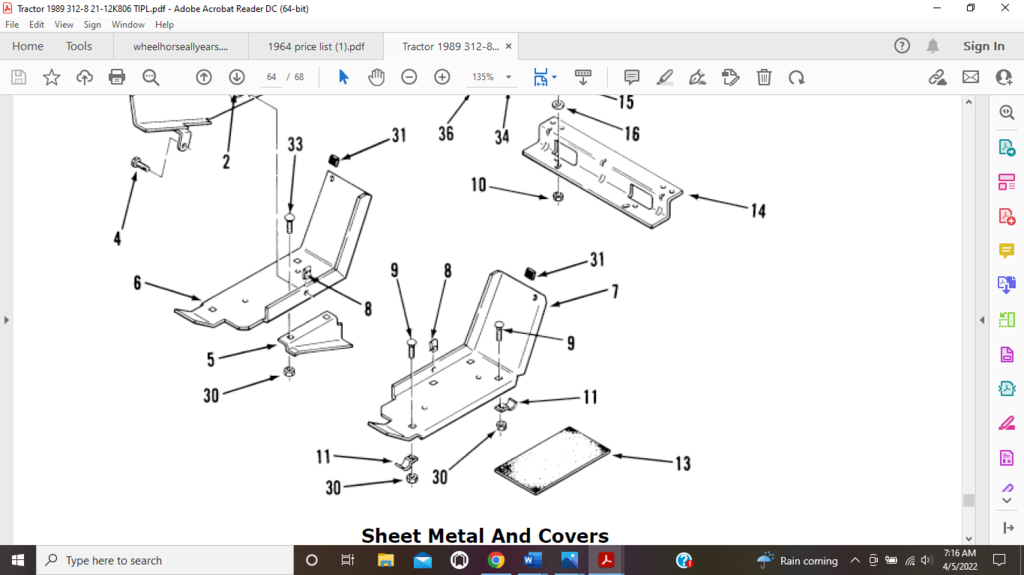

Dominator 68 #1 Posted April 5, 2022 Hello all, I hope this is the right place for the question I have. Just disassembled a 312. Noticed that both floorboards have some bare spots where the seat pan sits over them. Should there be a gap between the two surfaces, or is there something I could sandwich between them upon reassembly to prevent this? Thank you all as always, Dominator Share this post Link to post Share on other sites

953 nut 64,084 #4 Posted April 5, 2022 The part # 31 on this drawing is a small rubber bumper that attaches through a hole at the top of the running board and prevents the seat pan from contacting the riser of the running board. If they are missing on your 312 you can go to any good hardware store and find a couple of rubber bumpers to use in their place. 3 Share this post Link to post Share on other sites
