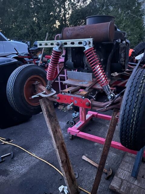

wallfish 20,724 #27 Posted April 18, 2022 So this seems to be moving along at the snail speed of Colossus (Sorry Eric, couldn't help it! LoL) And the only thing I'm a master of is baiting. It's a lot slower going than things were 10 years ago. Had some time to fiddle around on this Friday afternoon, some yesterday and some today. Mocked up a little bit on the front end suspension by making brackets and such to see how it would look then realized something will need to be done about the steering geometry to avoid bump steering or at least minimize it. If the tie rod ends aren't positioned correctly it will bump steer on it's own as each axle moves up and down. Pretty sure it's figured out how to proceed with that and made some parts but it definitely consumed some time instead of getting more parts stuck on there. I realize the purists might jump on this for cutting those axles but I probably have 5 or 6 and picked the worst two to use. There's always a bunch down at the big show if you need one. I was going to use other type axles but needed these to be short as possible so the front isn't wider than the back. Those coil overs are kind of tall for this build as shorter ones would probably look better to scale but these were already in stock from a long ago purchase. . 8 5 2 Share this post Link to post Share on other sites

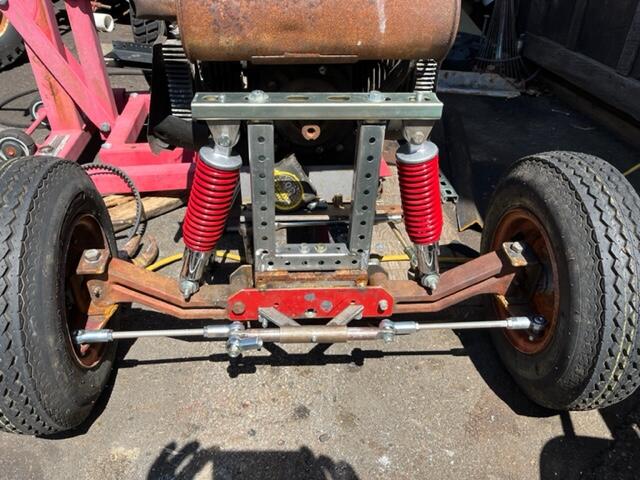

wallfish 20,724 #34 Posted April 20, 2022 Made up some shock mount brackets and attached them to the axles and re-did the Ackerman angles for the steering arms. Those angles had to change because the steering will now connect in the front instead of behind the spindles. Did a bunch of work on it but it basically still looks like the pic above without the clamps so no real updates. Waiting for some parts to arrive like heim joints Hoping to get that front end done by pecking away at it this week and then move on to the drive system. Considering turning the engine 90 deg but that means a tunnel down the middle with a driveshaft to the rear and a gear box or 2. The look of the engine turned 90 looks better to me but it makes for a more complex drive line set up with more points of failure too. 3 Share this post Link to post Share on other sites

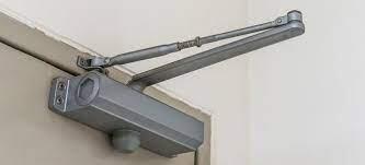

953 nut 70,061 #37 Posted April 21, 2022 I'v been kicking around the idea of a 953 side by side with two front axle halves for independant front suspension. Rather than coil overs I was thinking of using a pair of knee action shocks I have from from a '39 Pontiac. Looking forward to watching your progress. 2 1 Share this post Link to post Share on other sites
wallfish 20,724 #38 Posted April 21, 2022 15 minutes ago, 953 nut said: I'v been kicking around the idea of a 953 side by side with two front axle halves for independant front suspension. Rather than coil overs I was thinking of using a pair of knee action shocks I have from from a '39 Pontiac. Looking forward to watching your progress. I see the steering is moved to the side as well. Hmmm, 2 seater? Don't believe I've ever seen those type of knee shocks 1 Share this post Link to post Share on other sites
953 nut 70,061 #39 Posted April 21, 2022 11 hours ago, wallfish said: Don't believe I've ever seen those type of knee shocks They are somewhat the same as a door closer that has an adjustable rate. They were common on early automobiles. I will peobably need to run some sort of rod between the two half axles on the lower end of the bend to keep it from sagging. Also a pitman/idler arm steering set up to compensat for the added width 2 Share this post Link to post Share on other sites
wallfish 20,724 #40 Posted May 1, 2022 So it's slow going but pecking away. Had some time to play again. The steering set up seems good as far eliminating any bump steer but still need to figure out how to connect the rest of it back to the steering wheel and offset it to one side. The front suspension has been a bit more challenging than anticipated with some trial and error. I overestimated the strength of the springs on the coil overs. After doing adjustments, parts on and off and on again quite few times it's sitting on the ground like it should. Problem is --- it only allows about 1/2" of axle movement up until the shock bottoms out. Coils are adjusted for max pressure already. That really defeats the whole purpose of the suspension so heading back to the drawing board. Before looking for stronger springs or new coil overs I'm going to try moving the the bottom mounts out towards the tires. That should (in theory) equal less mechanical leverage against the coils compared to the existing location and put the pressure closer to the spindles. 3 2 Share this post Link to post Share on other sites
wallfish 20,724 #41 Posted May 1, 2022 Moving those lower shock mounts out towards the tires seems to work much better and the coils can be set softer. Still allows only about 1 1/2" of travel up but that should be plenty for what this is. 4 wheeling -- no good but cruising around at tractor shows - yes. Looks better with them closer to the center on the axles but oh well. Now to redo the upper shock mount bracket to something more permanent. I like using the steel stuff with the holes already in it because the plan is to drill holes all over everything like the old school race car guys did to lighten everything up. 1 Share this post Link to post Share on other sites
Sparky-(Admin) 26,621 #42 Posted May 1, 2022 16 minutes ago, wallfish said: Moving those lower shock mounts out towards the tires seems to work much better and the coils can be set softer. 4 wheeling -- no good but cruising around at tractor shows - yes. Looking forward to a “Cadillac soft ride” 😎 1 Share this post Link to post Share on other sites

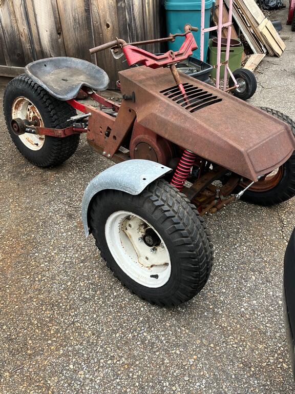

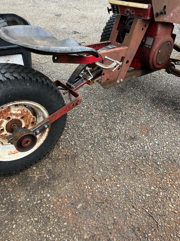

wallfish 20,724 #43 Posted March 27, 2023 Ugh, Getting close to a year since playing with this. Seeing some of the other guys doing stuff has motivated me to get some time in on it. It's taken a pretty big turn from the original plan as it seems everything I do does that. Anyway, here's an update for the change. Going Can-Am style bike Rear adjustable suspension swing arm is 2 Suburban lift handles. (They were twisted and damaged) The front is from the beginning. Again, trying to get as many wheel Horse parts on there as possible. 2 5 3 Share this post Link to post Share on other sites
SylvanLakeWH 32,777 #44 Posted March 27, 2023 That is cool And it's a Black Hood - sorta... 3 1 Share this post Link to post Share on other sites
WHX?? 58,324 #45 Posted March 27, 2023 Keep at it 'Fish... best part about under the apple tree work is that tree gets bigger providing more shade so take your time... Lets not get into EB's mode tho... 1 1 3 Share this post Link to post Share on other sites
Ed Kennell 47,750 #46 Posted March 28, 2023 Kool I won't tell, but the engines in backwards....probably only work for us southpaws. 1 Share this post Link to post Share on other sites
953 nut 70,061 #47 Posted March 28, 2023 Unless you are holding out on us you may need to alter the title of this thread. Hot Rod 2 seater Rat ? Share this post Link to post Share on other sites
wallfish 20,724 #48 Posted March 28, 2023 1 hour ago, 953 nut said: Unless you are holding out on us you may need to alter the title of this thread. Hot Rod 2 seater Rat ? Not holding out but there are still some parts on stand-by to continue a 2 seater build. And yes, a new thread should probably be started for this one. The front end just looked too wide on it after building it so this emerged. Plus, a Can-Am style bike is something that hasn't been done before as far as I'm aware. 3 Share this post Link to post Share on other sites
