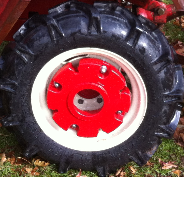

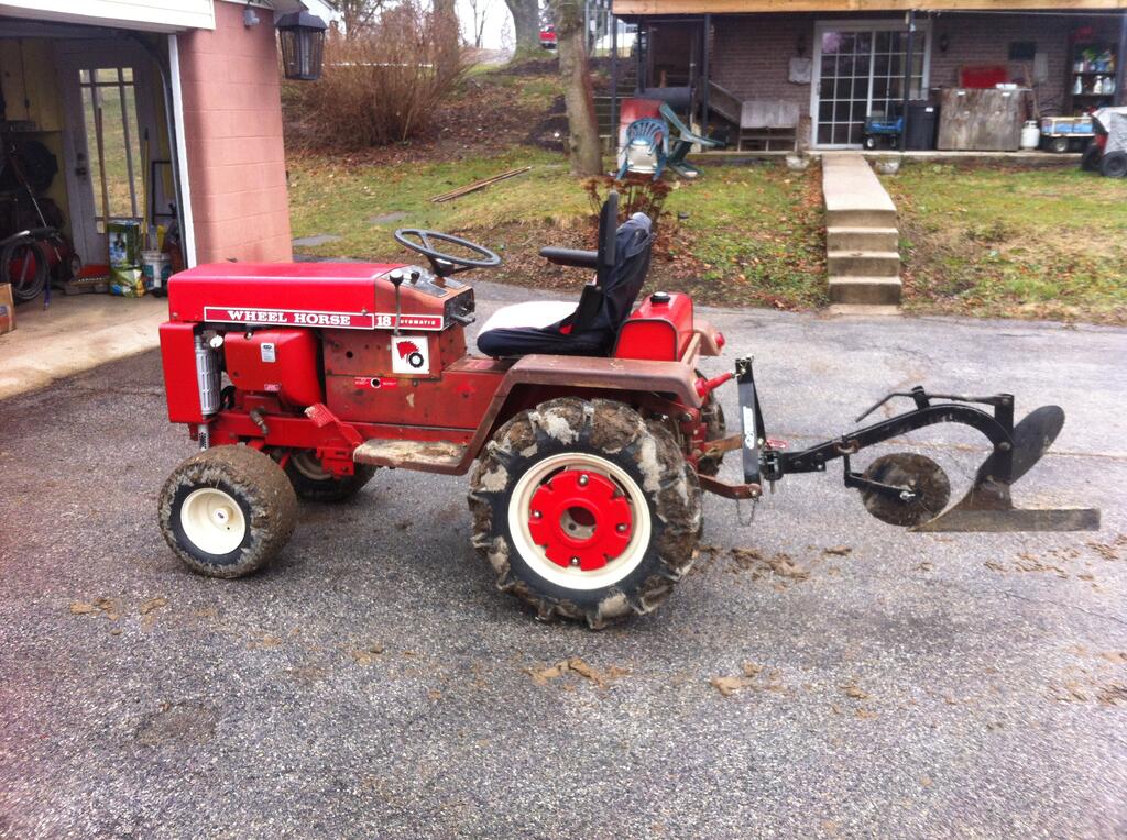

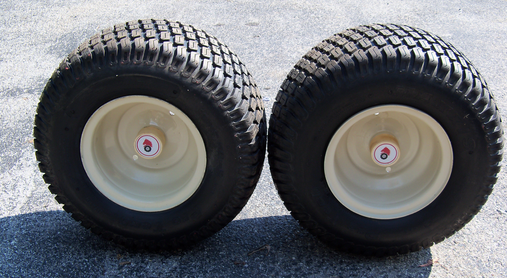

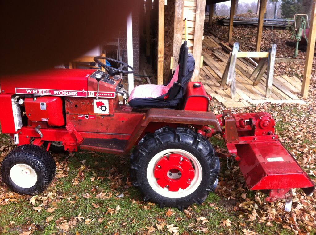

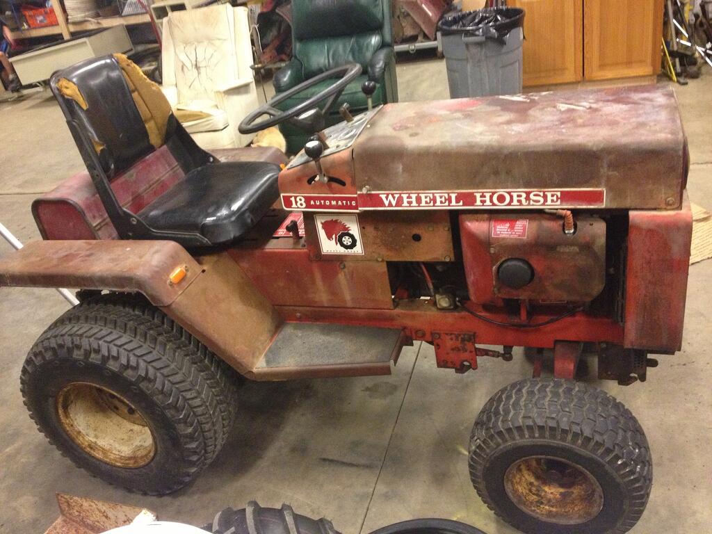

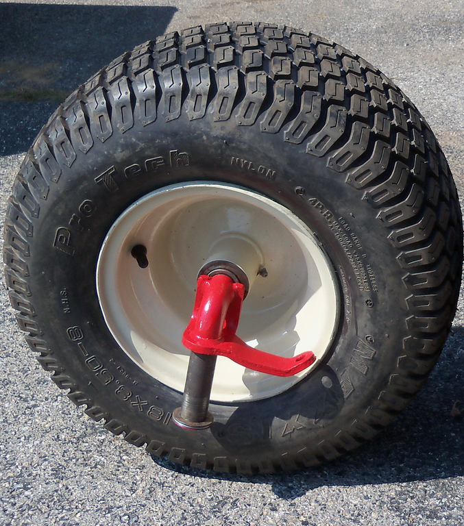

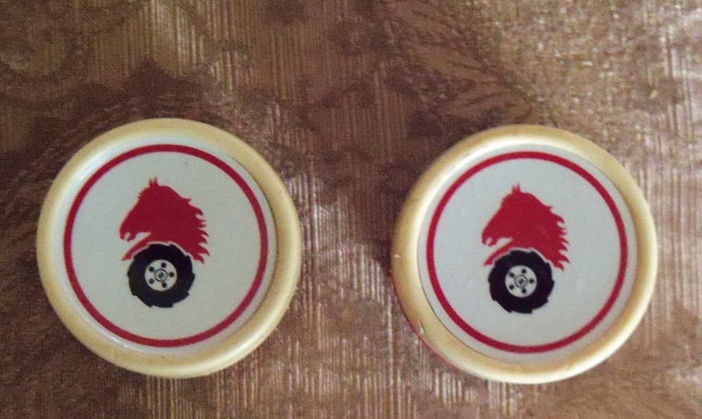

"Manic-Mechanic" 1,485 #1 Posted April 3, 2022 (edited) I had hopes of finding an ARK 550 so started with the axle upgrade. Found an axle assembly from Model 61-20 KS01 from a 1976 D-200 (1975 and up) Axle 104390 RH Front Spindle 104394 LH Front Spindle (Cannot find this part number!) Flanged Bearings 104396 (Almost impossible to find) Rims 104339 Everything was direct swap, nice I had to dry fit a spindle.. Front Wheels Set To Go! Refurbished Hubcaps with 2" Decal from Terry 16 x 32 Farm Harvester Tire to raise the rear as my Tiller bottomed out coming out of the garage! A nice set 75 lb IH Weights I love this shot! I enjoy just replacing/repainting sections of the assembly as repairs are done..She plows beautifully! I had to include a shot with the Tiller! Edited April 4, 2022 by "Manic-Mechanic" Cannot load pictures in sequence with text? 4 7 Share this post Link to post Share on other sites

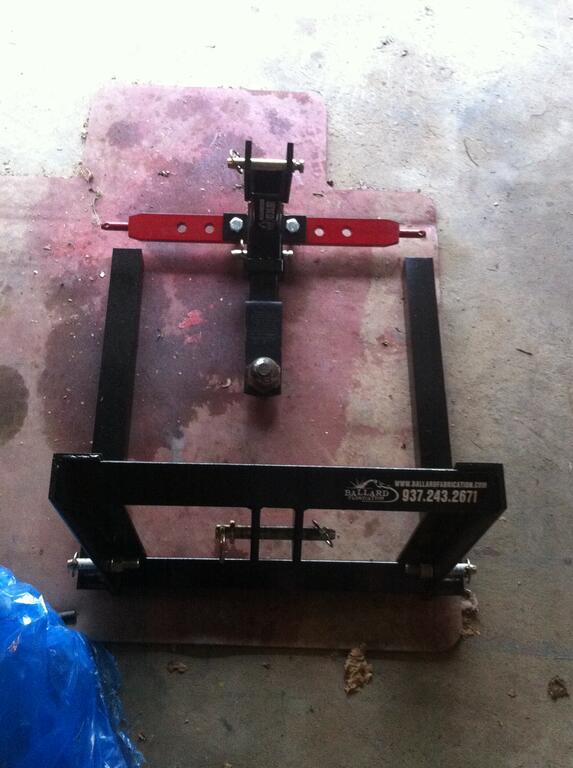

pacer 3,180 #4 Posted April 7, 2022 I have another request ..... I have a D180 also AND that plow AND that type hitch on the 3 point, but I have never figured how to connect the sleeve hitch set-up on the plow to the 3 point. Could you please post a pic of how yours is connected?? 1 Share this post Link to post Share on other sites
"Manic-Mechanic" 1,485 #5 Posted April 7, 2022 (edited) 24 minutes ago, pacer said: I have another request ..... I have a D180 also AND that plow AND that type hitch on the 3 point, but I have never figured how to connect the sleeve hitch set-up on the plow to the 3 point. Could you please post a pic of how yours is connected?? It's a "A" frame adaptor 3pt to sleeve, in 0 cat. made by a gentleman into fabrications. He makes "Carryalls" too. www.ballardfabrication.com. Not sure if he is still up and running, give him a call? Or just make one? I'll get some better shots then. Edited April 7, 2022 by "Manic-Mechanic" 1 Share this post Link to post Share on other sites
