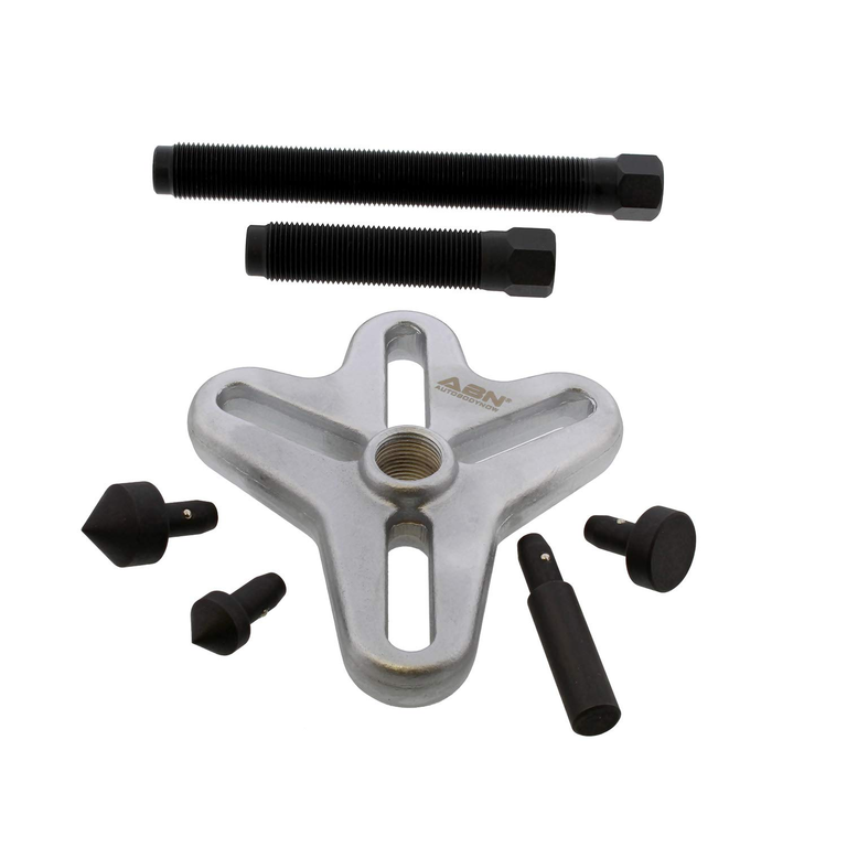

squonk 45,526 #5 Posted April 2, 2022 Harmonic balancer puller is what you need. Also known as a bolt grip puller. 2 Share this post Link to post Share on other sites
johnnymag3 2,635 #6 Posted April 2, 2022 I have 3 of them .... several sizes...but........whats the deal with no allen screw in either hole on the pulley Squonkster??? Share this post Link to post Share on other sites

squonk 45,526 #10 Posted April 3, 2022 Is the key even in the slot? I don't see it. I have pulled pulleys with the set screw key and all off of shafts before when the allen screw hex is damaged. Just need a good puller, new bolts and some thick washers for extra strength. Toss a puller on that pulley and see if it moves. Share this post Link to post Share on other sites
