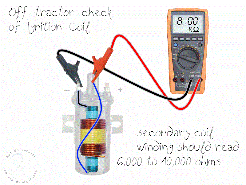

snowhound 106 #1 Posted April 2, 2022 Picked up a 417-8 that doesn't have any spark I don't know what year it is and the tag is to faided to read, it does have test lights. I've replaced the points and still no spark is there a way to test the coil. I've been trying to start it by using a remote starter switch to bypass the safety switches because when I turn the ignition to run the low oil light flashes but there is oil in it so I assume the switch is bad. Share this post Link to post Share on other sites
pfrederi 21,176 #2 Posted April 2, 2022 run a jumper from battery positive to the small plus terminal on the coil. (not the one that goes to the points/condenser) then crank it and see if you have spark 2 Share this post Link to post Share on other sites

953 nut 69,551 #4 Posted April 2, 2022 A member we haven't heard from lately provided these drawings, we miss you @Save Old Iron. 3 Share this post Link to post Share on other sites
