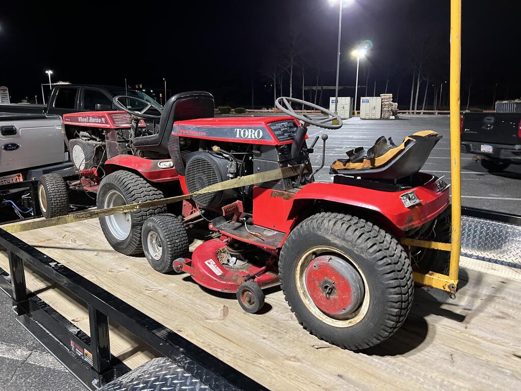

Bens vintage tractors 1,555 #1 Posted March 31, 2022 So I picked up a $50 417-A the other day (along with a more expensive 416-h lol). I have about 5 or 6 Diesel engines just sitting around and I think it’s time to put one on a tractor again. What do you guys think? Oh and I also pulled my “Honda horse” 520-8 out of winter hibernation. 5 7 Share this post Link to post Share on other sites

ebinmaine 75,816 #4 Posted March 31, 2022 11 minutes ago, Bens vintage tractors said: Bought it from a buddy his grandfather passed away before he could finish the 417. Engine supposedly runs. Got thinking about the diesel conversion. Have you done that on a hydro? You really can't gear those up or down any to gain speed. Another serious consideration would be the amount of torque that the transmission is capable of absorbing. Keep me posted on what you do with that engine please. I still have that little military one here for you too. 2 Share this post Link to post Share on other sites

953 nut 63,101 #8 Posted March 31, 2022 (edited) Nice load! A few things caught my eye on the 416. Seems like the rear rims are not as wide as they aught to be, are turned inward and what is the story on those wheel weights? The deck looks like it came from a vertical shaft , is it operable like that? Also, got to ask, What the heck is that yellow bar sticking up at the rear? Is it a lightning rod? Edited March 31, 2022 by 953 nut fat finger 8 Share this post Link to post Share on other sites
WHX?? 53,370 #9 Posted March 31, 2022 (edited) Does look like a vert deck 'Nut and someone would have to have done some connoitering to make it work & older rims. I missed the lightning rod thing and lovin the seat! Seat on the 417 looks the price of admission tho. Edited March 31, 2022 by WHX?? 4 Share this post Link to post Share on other sites

JoeM 9,323 #11 Posted March 31, 2022 1 hour ago, 953 nut said: Is it a lightning rod? Looks like lightning stuck the 416 and blew off the rear pan lights and went through the seat! Front tires are 6's and the rears look like cub rim / tire set up with the valve stem on the outside??? Lots of good stuff and fixable for sure. 2 6 Share this post Link to post Share on other sites

wh500special 2,359 #17 Posted April 1, 2022 (edited) 12 hours ago, 953 nut said: The deck looks like it came from a vertical shaft , is it operable like that? … That’s a 37” side discharge deck. it’s made for the C/300/400 tractors. Uses a single hexagonal cross section belt that wraps around the PTO pulley, through the idler, and around both spindles. Some of the 1990-ish tractors came with 6” front rims to accommodate that deck. I think they might have had 22” diameter rear tires too. The deck is arranged sort of diagonally in there so the blades overlap and it makes it quite long from front to back. So bigger tires would interfere. the rear tires and wheels are obviously from something else. It’s the same shell used on a bunch of vertical shaft tractors. it’s a great cutting deck compared to the three blade 48 and especially 42 incher which are pretty lousy in comparison. Steve Edited April 1, 2022 by wh500special 5 1 Share this post Link to post Share on other sites
dcrage 631 #18 Posted April 1, 2022 3 hours ago, wh500special said: That’s a 37” side discharge deck. it’s made for the C/300/400 tractors. Uses a single hexagonal cross section belt that wraps around the PTO pulley, through the idler, and around both spindles..,, Some 37” SD decks use a regular V-belt. When this is done there has to be flat idlers on the deck and on one side of the mule drive. The 6 sided belt driven 37” SD has all ‘v grooved’ pulleys. 2 Share this post Link to post Share on other sites
Bens vintage tractors 1,555 #19 Posted April 1, 2022 17 hours ago, 953 nut said: Nice load! A few things caught my eye on the 416. Seems like the rear rims are not as wide as they aught to be, are turned inward and what is the story on those wheel weights? The deck looks like it came from a vertical shaft , is it operable like that? Also, got to ask, What the heck is that yellow bar sticking up at the rear? Is it a lightning rod? They plowed with it on sidewalks. That pole is for a beacon. The weights are a classic style my pulling club use to use. They are solid lead! 4 2 Share this post Link to post Share on other sites
