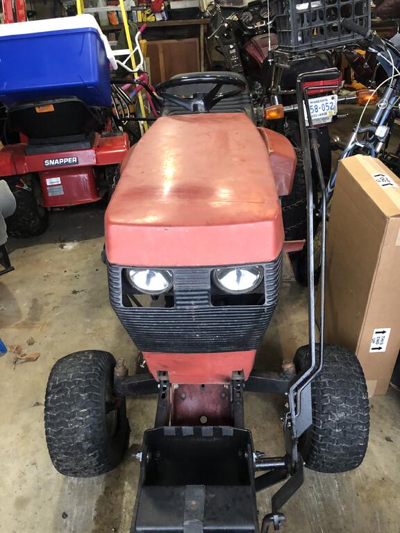

Picked up this Horse for the blade but there is no ID tag or model numbers anywhere on it. It is running a 10 Horse Kohler though.

80's 310-8, not an original toro / wheel horse plow blade.

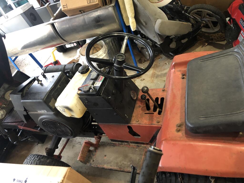

  It’s a 300 series. Interesting fuel tank setup. Makes me wonder if it was a 308 originally which means it wouldn’t have had an under the fender fuel tank.
  Plow looks like it’s a Sears light duty unit for their LT series tractors.

Little bit of a hob-job but they all need lovin!

It appears that previous owners have made a few modifications but it is a 300 series. If you tilt the seat forward is there a fuel tank that has been abandoned? The lack of a volt meter and test lights tells me it is a 308 or 310. The steering wheel suggests 1985 to 1987 I think. Parts are interchangeable on most of them anyway.
