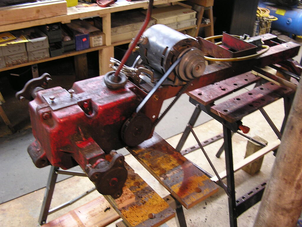

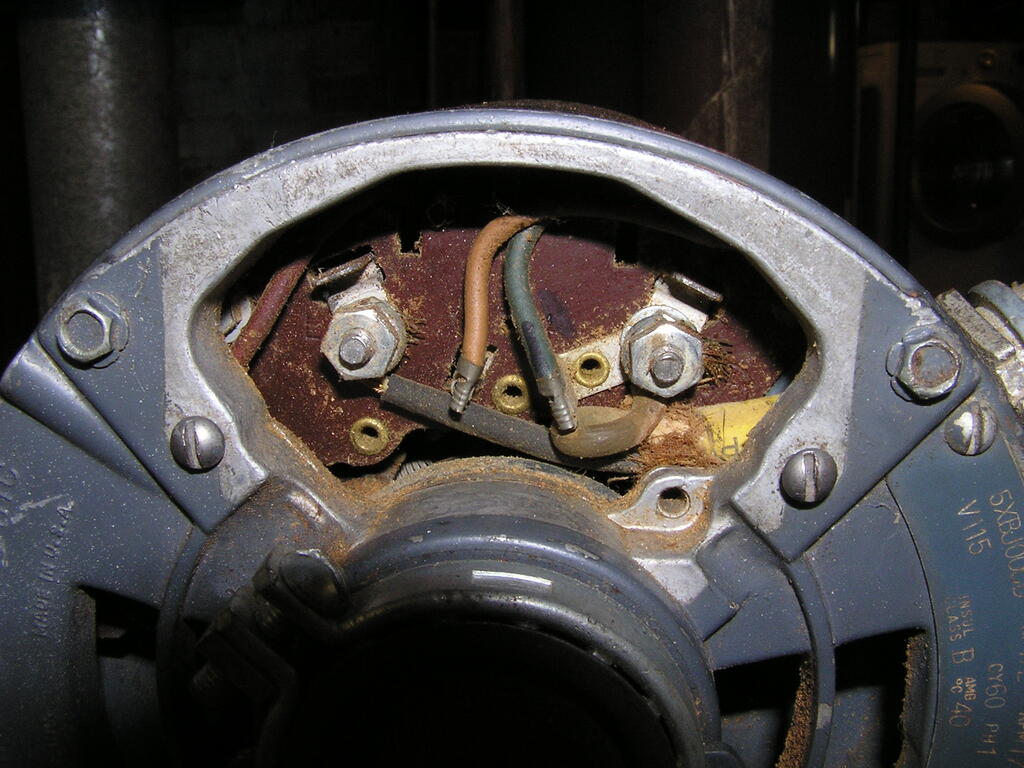

ri702bill 10,549 #1 Posted March 29, 2022 (edited) The original 5025 Unidrive on my 502 roller was completely full of water when I got it 8 or so years ago - what was left of the shifter boot looked like a used-up faucet washer, so I scrounged thru the "Parts Department" and came up with 2 potential candidates. It is not easy to find a 110-volt motor that has reversable rotation. My other 2 choices were to find a double shaft version, or to overhang mount the motor off the frame - not a good choice. I did find one off of the Shopsmith Mk 5' complete with 3 prong plug and an On/Off switch - and it did have 2 additional wires with Fast-ons - switched them and it now runs CCW. (like an electric Kohler!!) The first Unidrive had noise issues and 4 leaking seals; after 2 flushes it got no better. The second one as shown was quiet and had 2 leaking seals. Drained what oil was in there, raising the front of the frame. Set the front back down, added 2 quarts of Diesel fuel thru the shifter hole and ran it on low speed thru all 4 gears, 10 minutes apiece. Repeated using the middle step and the largest step. Drained that, ready for new seals. If you think you MAY have a seal that is leaking, the thin Diesel fuel will let you know very quickly... Edited March 29, 2022 by ri702bill 10 5 Share this post Link to post Share on other sites

stevasaurus 23,512 #10 Posted March 29, 2022 Actually, all you had to do, turn the motor around so the pulley is lined up and the motor is on the right side. Or figure "8" a fan belt, like Kevin said. 4 Share this post Link to post Share on other sites

wallfish 18,773 #13 Posted March 29, 2022 7 hours ago, ri702bill said: It is not easy to find a 110-volt motor that has reversable rotation. True! Where did you find that one or was it something you already had? I don't think it would hurt the trans to run it in reversed rotation. Might even help to run it both directions when cleaning it out too. 4 Share this post Link to post Share on other sites

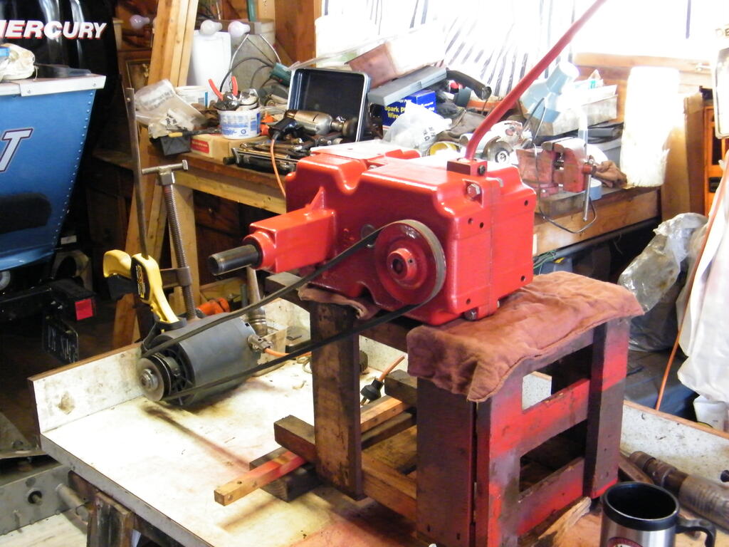

stevasaurus 23,512 #14 Posted March 29, 2022 It shouldn't hurt the trans to run it in the opposite direction, but if you look down the shifter hole when running it in the counter-clock-wise direction, you will get the appreciation for how the transmission oils itself. It is worth the look !! 4 1 1 Share this post Link to post Share on other sites
ri702bill 10,549 #15 Posted March 29, 2022 1 hour ago, wallfish said: Where did you find that one or was it something you already had? Yup - the Parts Department coughed up a worthy motor...from the "I just MAY have a use for this thing, but not just now, I'll leave it here shelf !! Bill 1 4 Share this post Link to post Share on other sites

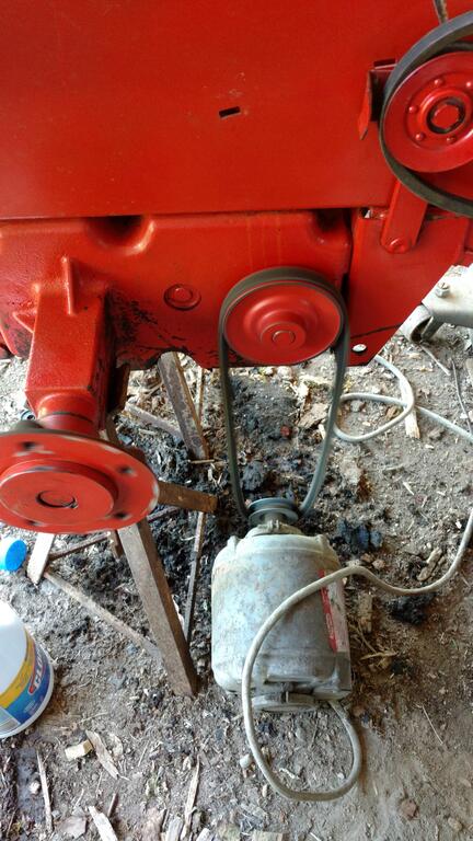

Handy Don 15,110 #19 Posted March 30, 2022 (edited) Hey @davem1111, check out the top of this thread. Got a spare motor to hook up to test your 700? Edited March 30, 2022 by Handy Don 2 1 Share this post Link to post Share on other sites
gt14rider 969 #20 Posted March 30, 2022 Just turn motor around to change direction, short belt,just let motor hang for tension. 4 Share this post Link to post Share on other sites
stevasaurus 23,512 #21 Posted March 30, 2022 This is from 2011...Brrly1's #5007 tranns. 6 Share this post Link to post Share on other sites
davem1111 2,253 #22 Posted April 3, 2022 On 3/29/2022 at 10:17 PM, Handy Don said: Hey @davem1111, check out the top of this thread. Got a spare motor to hook up to test your 700? Unfortunately I do not... probably should have pulled the motor from the old wash machine before scrapping it last year. I love ideas like this, and the challenges that prompt our brains to come up with them. 2 Share this post Link to post Share on other sites
