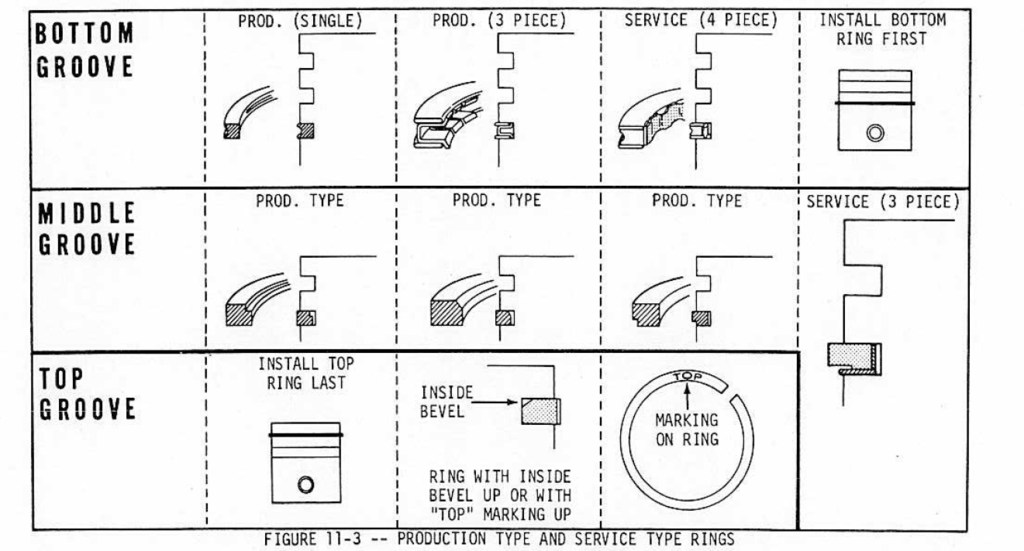

WHX?? 52,908 #7 Posted March 29, 2022 (edited) Not too far Dan I did find this.... 'course this may not apply to aftermarket rings??? Edited March 29, 2022 by WHX?? 2 3 Share this post Link to post Share on other sites
Wheelhorse#1 1,879 #8 Posted March 29, 2022 (edited) All .Thanks for the great info,very much appreciated .I have a set of standard NOS rings I bought a wile back. This 8horse I bought for a song and dance and a couple wooden nickels! With just minor maintenance, it runs great and zero smoke. Inwas thinking of throwing rings in it but after looking at the cylinder It looks surprisingly good. I guess at some point it was at least re-ringed,can even see the cross hatches still there. I was amazed when I got these Kohler rings in the mail. Now that’s what I call quality .The price marked on them is $13.25😉that’s certainly not close for what I paid for them, Edited March 29, 2022 by Wheelhorse#1 1 1 Share this post Link to post Share on other sites
