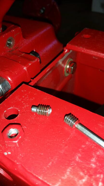

41chevy 74 #1 Posted March 28, 2022 1976 B 80, 5190 8 speed trans shifter Allen screw (PN 915111 ) I’ve looked for an hour and given up, is it a half bite or full bite lock screw and is it a hardened screw. Also due you bottom it in the hole then lock it or back it up a hair off bottom then lock it? Thx Steve Share this post Link to post Share on other sites
953 nut 60,928 #2 Posted March 29, 2022 It is a 1/4-20 dog-point screw and yes, it is hardened. 2 Share this post Link to post Share on other sites
AMC RULES 37,221 #3 Posted March 29, 2022 https://www.mcmaster.com/dog-point-set-screws/ 4 Share this post Link to post Share on other sites
Handy Don 14,259 #4 Posted March 29, 2022 56 minutes ago, 41chevy said: back it up a hair off bottom then lock it? I bottom it gently, then back off until the shifter is just able to access all the gears smoothly and easily--it'll feel a bit "loose"--then I tighten the lock nut while holding the dog point in place with the hex wrench. 7 Share this post Link to post Share on other sites
Racinbob 12,043 #5 Posted March 29, 2022 You can get them at Fastenal too. 1/4"-20 x 3/4" Hex Drive Full Dog Point Black Oxide Finish Alloy Steel Socket Set Screw | Fastenal 1 1 Share this post Link to post Share on other sites
WHX?? 52,210 #6 Posted March 29, 2022 (edited) I can look and see if I have them and send you one. Cost ya a cupojoe and price of a stamp. I have made one in a pinch. 1/4-20 x 3/4 long set screw in the Hillman drawers at any bigger hardware store. Just grind the threads off the first 1/8" or so. one inch ones work too. Think my homemade one is still on a tractor. I have 20 tractors so which one!?!?!? Don't over tighten this can happen ..... Hey I was a newbie! Edited March 29, 2022 by WHX?? 2 Share this post Link to post Share on other sites
