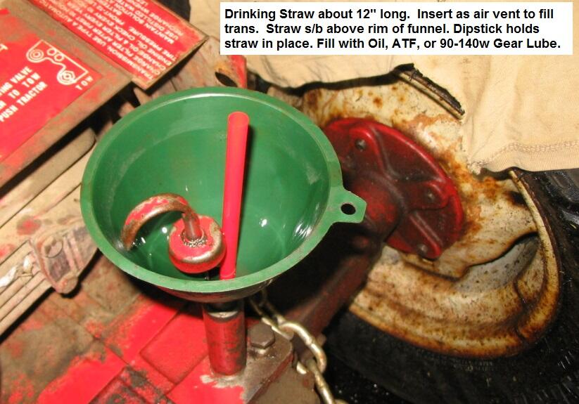

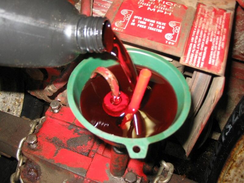

SylvanLakeWH 30,634 #10 Posted March 28, 2022 45 minutes ago, Pullstart said: Next time… if you unscrew one of those 3/8” bolts next to the dipstick tube, that’ll give the air a place to go Or a straw on side of funnel… used both - they work. 4 Share this post Link to post Share on other sites

daveoman1966 3,882 #13 Posted March 28, 2022 Easy and quickest way I've found: 6 Share this post Link to post Share on other sites
