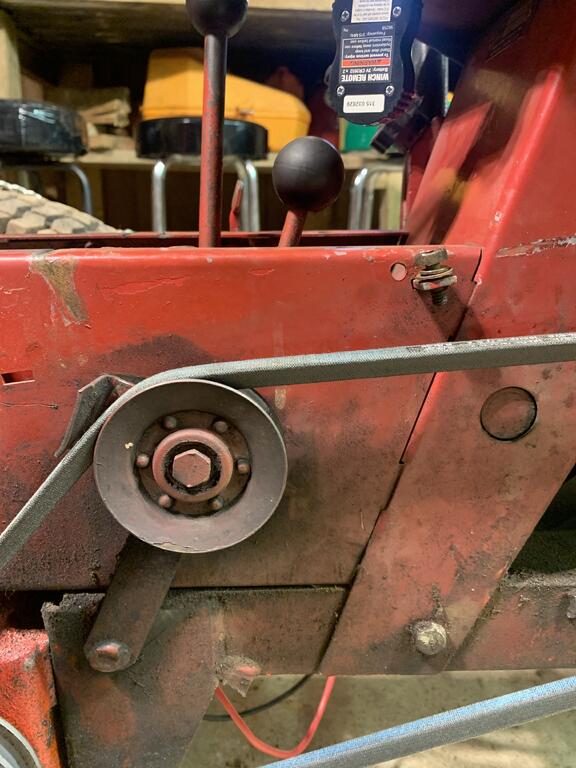

peter lena 9,779 #2 Posted March 27, 2022 @857lover when was the last time you changed trans fluid ? have you ever lubricated related linkage movement points? how is the condition of that idler pulley and follow spring tension? every related cross frame mount shaft , should have needed lubrication . just going over a basic functional check , to find the fault spot . with that exposure level , you should be able to find it , maybe have someone else drive it in low range , so you can visually see what is possibly going on . leaning toward, rusty linkage movement areas , if there is the slightest delay in spring tension on that idler pulley , that could cause your issue . just some ideas , pete 1 Share this post Link to post Share on other sites
857lover 291 #3 Posted March 27, 2022 (edited) 9 minutes ago, peter lena said: @857lover when was the last time you changed trans fluid ? have you ever lubricated related linkage movement points? how is the condition of that idler pulley and follow spring tension? every related cross frame mount shaft , should have needed lubrication . just going over a basic functional check , to find the fault spot . with that exposure level , you should be able to find it , maybe have someone else drive it in low range , so you can visually see what is possibly going on . leaning toward, rusty linkage movement areas , if there is the slightest delay in spring tension on that idler pulley , that could cause your issue . just some ideas , pete has fresh trans fluid just changes two weeks ago when i did the swap the idler pulley spins freely and smoothly and you mean fololower spring tension as in the spring on the other side of the transmission i have a 1267 with what i belive to be the same transmission i can quickly swap springs and see what happns Edited March 27, 2022 by 857lover 1 Share this post Link to post Share on other sites
peter lena 9,779 #4 Posted March 27, 2022 @857lover yes , that related shaft movement to spring pull , or failure will affect its transfer of power to the transaxle. my experience with possible rusty issues , is to aerosol lubricant spray and move dry areas till the rust runs out , glad your trans oil is new , that by itself , is showing you the way , that the problem is probably linkage related , and not in the trans . , that makes things easier , that clutch pedal should take up very smoothly , with no sudden grabbing , find it , its in the related linkage . greasy , pete 1 Share this post Link to post Share on other sites

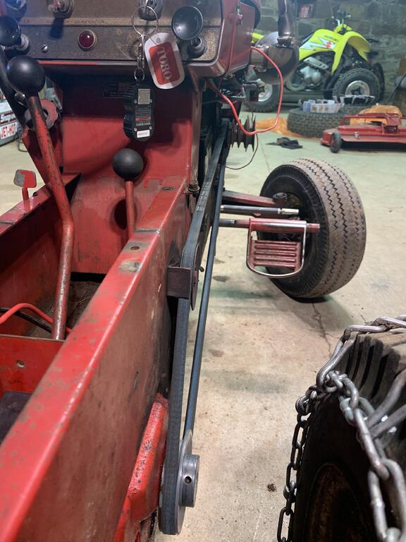

squonk 45,591 #10 Posted March 27, 2022 13 minutes ago, Handy Don said: This thread and the "bogging down in 3rd" thread both indicate worn belt. Has that been tried? By his pics belt doesn't look bad. This problem seems to have cropped up when the trans was swapped. He mentioned one of the hubs was sliding on the axle in his other thread. I want pics of the axles and hubs. 3 1 Share this post Link to post Share on other sites

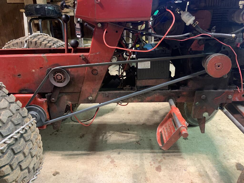

Ed Kennell 45,014 #11 Posted March 27, 2022 2 hours ago, 857lover said: the belt just starts slipping any ideas Where, on the engine pulley or the tranny pulley? 2 Share this post Link to post Share on other sites
857lover 291 #12 Posted March 27, 2022 45 minutes ago, squonk said: I'm assuming you put the key in for the transmission pulley? Did you ever check the axle shaft keys from the last time you posted about tractor stopping when you got stuck and you said a hub was sliding on an axle? Since this issue started with the trans swap I'm sure the issue is there and not with the belt or idler. i was just at my hardware store picked up a spring and put it on its a little tighter of a spring and that seemed to help a lot im not sure if the wheel will spin now when i get stuck also there is a woodruf key on my transmission pulley and i dont think my hubs are the problem as they have not moved since i adjusted them Share this post Link to post Share on other sites
857lover 291 #13 Posted March 27, 2022 Just now, Ed Kennell said: Where, on the engine pulley or the tranny pulley? im really not sure i look at the engine pulley first because its the easier one to see and the belt like stops movin but the pulley is still moving and after only a couple seconds it starts smoking really fast Share this post Link to post Share on other sites
Ed Kennell 45,014 #14 Posted March 27, 2022 (edited) 4 minutes ago, 857lover said: the belt like stops movin but the pulley is still moving So it is slipping on the engine pulley. That tells me the idler/tensioner pulley is not creating enough tension. weak spring, sheared roll pin in the cross shaft, belt botteming out in the engine pulley Edited March 27, 2022 by Ed Kennell 4 Share this post Link to post Share on other sites
857lover 291 #15 Posted March 27, 2022 1 minute ago, Ed Kennell said: So it is slipping on the engine pulley. That tells me the idler/tensioner pulley is not creating enough tension. weak spring, sheared roll pin in the cross shaft yea i threw on another spring and it seemed to really help it a lot not sure if its 100 percent but its definitely 1000 times better 1 Share this post Link to post Share on other sites

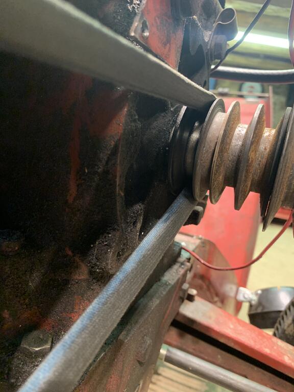

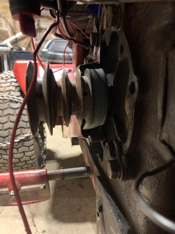

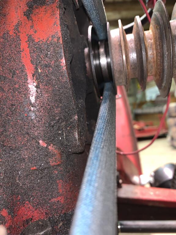

squonk 45,591 #16 Posted March 27, 2022 How bout a close up pic of the engine pulley and how the belt rides on it. That pulley isn't stock Share this post Link to post Share on other sites

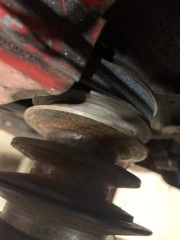

squonk 45,591 #18 Posted March 27, 2022 (edited) How about a close up pic of the front pulley from this angle ? I'm wondering if the pulley groove is worn or 2 wide for the belt. That outer groove almost looks like it's for a 5/8" belt Edited March 27, 2022 by squonk Share this post Link to post Share on other sites
squonk 45,591 #20 Posted March 27, 2022 (edited) Belt looks too deep in the pulley. The inside flat edge of the belt shouldn't be riding on the inner face of the pulley. Also the belt outer edge is below the pulley outer edge. Compare it to how the belt sits on your trans pulley. You need the proper width pulley. I have the proper engine pulley for that tractor. Edited March 27, 2022 by squonk 2 1 Share this post Link to post Share on other sites
857lover 291 #21 Posted March 27, 2022 2 minutes ago, squonk said: Belt looks too deep in the pulley. The inside flat edge of the belt shouldn't be riding on the inner face of the pulley. Also the belt outer edge is below the pulley outer edge. Compare it to how the belt sits on your trans pulley. You need the proper width pulley its a half inch belt so you think i need to change the engine pullet to one that is 1/2 ? what size do you think the current engine pulley is 1 Share this post Link to post Share on other sites
peter lena 9,779 #22 Posted March 27, 2022 @857lover from that related belt debris on the engine side , no wonder the new spring helped the tension . another thing looks like the engine pulley is a 5/8 , not giving you the side bite to the narrower belt , probably wrong pulley . pete Share this post Link to post Share on other sites
squonk 45,591 #23 Posted March 27, 2022 (edited) 2 minutes ago, 857lover said: its a half inch belt so you think i need to change the engine pullet to one that is 1/2 ? what size do you think the current engine pulley is Yes you need a 1/2" width pulley. That pulley looks like 5/8" Edited March 27, 2022 by squonk 1 Share this post Link to post Share on other sites
857lover 291 #24 Posted March 27, 2022 1 minute ago, peter lena said: @857lover from that related belt debris on the engine side , no wonder the new spring helped the tension . another thing looks like the engine pulley is a 5/8 , not giving you the side bite to the narrower belt , probably wrong pulley . pete yeah but even when i had my 3 speed it always worked really good and ive never had a issue Share this post Link to post Share on other sites
