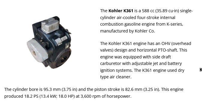

pfrederi 20,619 #2 Posted March 26, 2022 No power steering on classic WHs 18 hp were overhead valves would have a valve cover on the head. 2 Share this post Link to post Share on other sites
