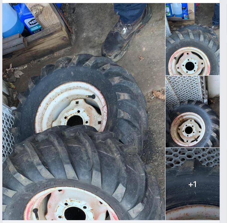

41chevy 74 #1 Posted March 23, 2022 Good morning. Will these tires fit my B 80 26x12x 1200? 1 Share this post Link to post Share on other sites
ebinmaine 77,305 #2 Posted March 23, 2022 They won't be a direct bolt on. You may have to use wheel spacers and you WILL have to raise the fender some. Likely also cut the rear piece of the footstep or do some other alteration. 2 Share this post Link to post Share on other sites
41chevy 74 #3 Posted March 23, 2022 Just now, ebinmaine said: They won't be a direct bolt on. You may have to use wheel spacers and you WILL have to raise the fender some. Likely also cut the rear piece of the footstep or do some other alteration. Thanks for the quick reply, I just saw them for sale mounted on wheel horse rim's, says like new for 150 and they are close to me, figured I’d offer 100 and go from there. 3 Share this post Link to post Share on other sites

953 nut 64,085 #5 Posted March 23, 2022 The tires that are on your B-80 are probably 23" diameter so there would be changes needed anyplace you don't have 1 1/2" clearance now. 1 Share this post Link to post Share on other sites
pacer 3,179 #6 Posted March 23, 2022 As the guys have already mentioned, you may can get them to fit up ..... but theres gonna have to be some mods made and it could turn into more than the low cost will justify. Thats the tires I have on my D tractors!! theyre BIG!! 1 Share this post Link to post Share on other sites
Moparfanforever 918 #7 Posted March 23, 2022 You better get them even if they are $150,if they are in good shape seems like a fair price. And you know you will end up buying another tractor that they may fit !! !! 2 Share this post Link to post Share on other sites
pfrederi 19,870 #8 Posted March 23, 2022 Hard to be sure from the pictures but the backset looks wrong for a WH.. Most WHs used 1-3/8 inch this looks more like the 2-3/8 used but many other companies 1 1 Share this post Link to post Share on other sites
oliver2-44 11,212 #9 Posted March 23, 2022 Verify they are actually on wider rims than you already have . Its hard to say ibut in the picture the tire tread looks rounded verses flatter. may just be the camera angle, but a good thing to verify. 1 Share this post Link to post Share on other sites
