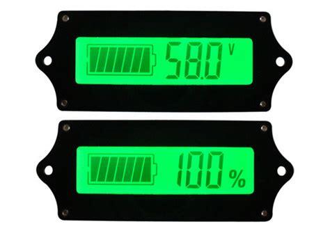

SylvanLakeWH 30,493 #1 Posted March 19, 2022 Looking to add three 12 v Battery voltage / capacity meters to my E 141. (It can run on three or six batteries - I’m running with three). Looking for recommendations on type and manufacturers. (Mods I put this here instead of the electric tractors page because it is really applicable to all wheel horses that have batteries and should get better exposure - move if you wish). Something like this, but dash space is limited… Appreciate any advice… 3 Share this post Link to post Share on other sites

SylvanLakeWH 30,493 #3 Posted March 19, 2022 As I understand it - Any battery. Most have a range from 6v up to 48 or even higher…They monitor voltage and % power remaining… Share this post Link to post Share on other sites
ebinmaine 77,093 #4 Posted March 19, 2022 24 minutes ago, SylvanLakeWH said: They monitor ******** % power remaining That's the part that's interesting to me. (Voltage is easy enough with a dash voltmeter.) Share this post Link to post Share on other sites
JoeM 9,579 #5 Posted March 19, 2022 1 hour ago, ebinmaine said: That's the part that's interesting to me. Back in my EV days, that was all done via calculation using battery voltage. On a 12 volt battery, 12.7 was considered full, below 11.5 volts < dead or lower than 20% power. Sweep meters used coordinated background gradients as the voltage decreased. New versions used fancy bars like the ones pictured. Battery Maintenance, including charging, was the key to long battery life not to mention a good vehicle performance. Good motor controllers will turn off when the battery voltage is to low. This prevents the overheating of components due to high current flow. As far as I know no magic in the gauge. 2 Share this post Link to post Share on other sites
ebinmaine 77,093 #6 Posted March 19, 2022 15 minutes ago, JoeM said: battery voltage. On a 12 volt battery, 12.7 was considered full, below 11.5 volts < dead or lower than 20% power Seems reasonable to me. Back in the mid 90s when I sold AC Delco batteries we were told a decent battery was 12.45V or higher. Anything 10.8 (I think?) Was considered "needs charging" or dead. 18 minutes ago, JoeM said: that was all done via calculation So basically a battery life gauge is another method of showing available voltage? 1 Share this post Link to post Share on other sites
pfrederi 19,801 #7 Posted March 19, 2022 23 minutes ago, ebinmaine said: So basically a battery life gauge is another method of showing available voltage? Yes and the big issue an older tired battery may show 12.6 volts (100%) but it will drop off much faster under load than a new healthy battery. So the gauge may show 50% on a battery. That may mean some cranking left if it was in good shape, or very little cranking if it is older/tired. 2 1 Share this post Link to post Share on other sites
