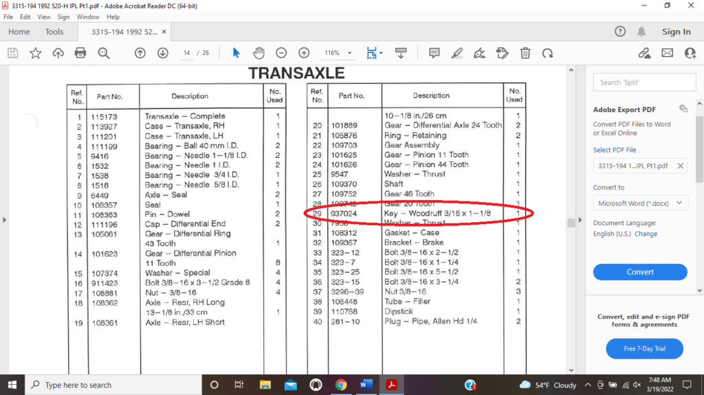

ebinmaine 74,517 #7 Posted March 19, 2022 9 hours ago, Achto said: File to fit ensures a tight fit. A VERY good pair of locking pliers/Vise grips and a belt sander - used with much care - can help. 14 hours ago, Rick 55 BB said: assortment of woodruff keys specific to wheel horse Not likely something like that exists. Wheelhorse company used many Standard Parts. Nuts, bolts, belts, clips, washers, spacers, bearings, seals, collars, wire holders, wire terminals and so on. .... Woodruff keys too. To get a specific assortment of WH keys I'd think the best bet is to accurately measure each one you remove and get a good replacement from McMaster Carr. Keep the list handy for future reference. The challenge I've noticed is that WH were designed built engineered back 50+ years ago. The "Standard" of Standard Parts has likely changed. 4 Share this post Link to post Share on other sites
953 nut 62,129 #8 Posted March 19, 2022 14 hours ago, Rick 55 BB said: anyone know of a place to get an assortment of woodruff keys specific to wheel horse ? If you go through the IPL for your specific tractor each woodruff key is shown and the size is given. Once you have developed a comprehensive list of all the keys that fit your tractor you could buy them from https://www.mcmaster.com/keys/key-type~woodruff/ 4 Share this post Link to post Share on other sites

gwest_ca-(File Mod) 11,729 #10 Posted March 19, 2022 In the early years the keys were listed as a part number only with no dimensions or Woodruff identification. There was a site with a reverse look-up for part numbers years ago. One could enter a part number and each illustrated parts list would come up with the part description. Most had "key" only but the odd ipl would have dimensions or the Woodruff identifier or a superseded part number one could search so one knew what it was. What I learned was recorded and added to a chart. Keys are sized by the cutter that is used to make the pocket so key size is larger than the actual key. This 3-page chart lists the key size and the actual key dimensions. This 8-page chart lists the Wheel Horse part number and the Woodruff number It was copied from a searchable database but since it is no longer searchable the results are mixed up. You have to look for the correct line. 3 2 Share this post Link to post Share on other sites
pfrederi 18,966 #11 Posted March 19, 2022 There is only on key hard to find that is the axle key on D series GT-14 and i believe 953s #RX Even McMaster doesn't have them. I bought a pack from Fastenal some time ago if anyone needs them... 1 2 1 1 Share this post Link to post Share on other sites
Rick 55 BB 24 #12 Posted March 19, 2022 1 hour ago, gwest_ca said: In the early years the keys were listed as a part number only with no dimensions or Woodruff identification. There was a site with a reverse look-up for part numbers years ago. One could enter a part number and each illustrated parts list would come up with the part description. Most had "key" only but the odd ipl would have dimensions or the Woodruff identifier or a superseded part number one could search so one knew what it was. What I learned was recorded and added to a chart. Keys are sized by the cutter that is used to make the pocket so key size is larger than the actual key. This 3-page chart lists the key size and the actual key dimensions. This 8-page chart lists the Wheel Horse part number and the Woodruff number It was copied from a searchable database but since it is no longer searchable the results are mixed up. You have to look for the correct line. Well thank you , I think this is as close as I have to the dimensions as I will ever get of what I need . I have a guy who repairs my worn out or damaged shafts and hubs , so I will just take the keys along with them and let him machine the keys to fit . I have been doing it myself but with a file and grinder it's time consuming and not as accurate . I bought a dozen # 9 keys for the axles . Thanks again 2 Share this post Link to post Share on other sites
