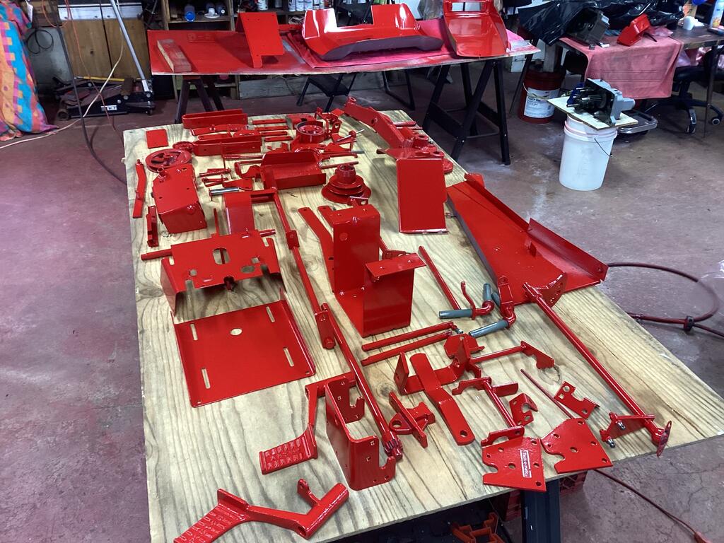

41chevy 74 #35 Posted March 23, 2022 1 hour ago, lynnmor said: I see, that’s where I buy all my fuel. Saved $.66 per gallon with the tax holiday. If you need some help, just PM me. Thx, I don’t blame you it’s worth the drive. So far it’s going good, this is my first complete tear down. I’ve taken pictures of everything as I took it apart. I do have a B 100 that I can refer to also when putting it back together. 1 3 Share this post Link to post Share on other sites
