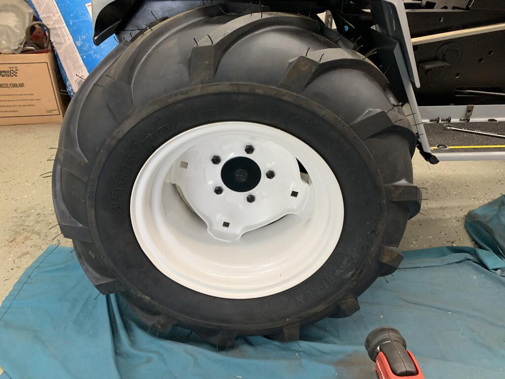

Jeff-C175 7,211 #26 Posted March 16, 2022 12 hours ago, nataliator said: square head bolts ... (inner side of rear hubs, for example). Don't loosen them, but if you do, you need to tighten then to 30 ft lb torque which can't be achieved with a small open end wrench. You'll need a ratchet with an 8 point socket 2 Share this post Link to post Share on other sites

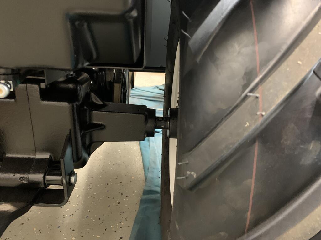

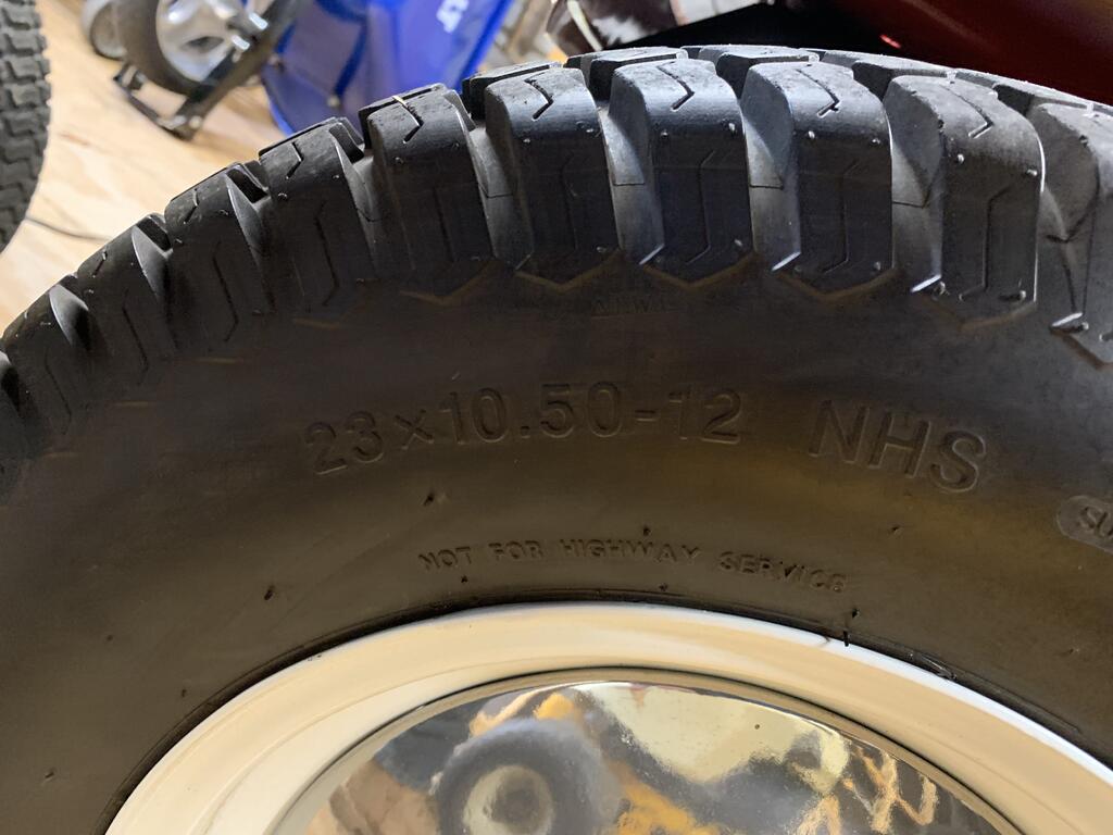

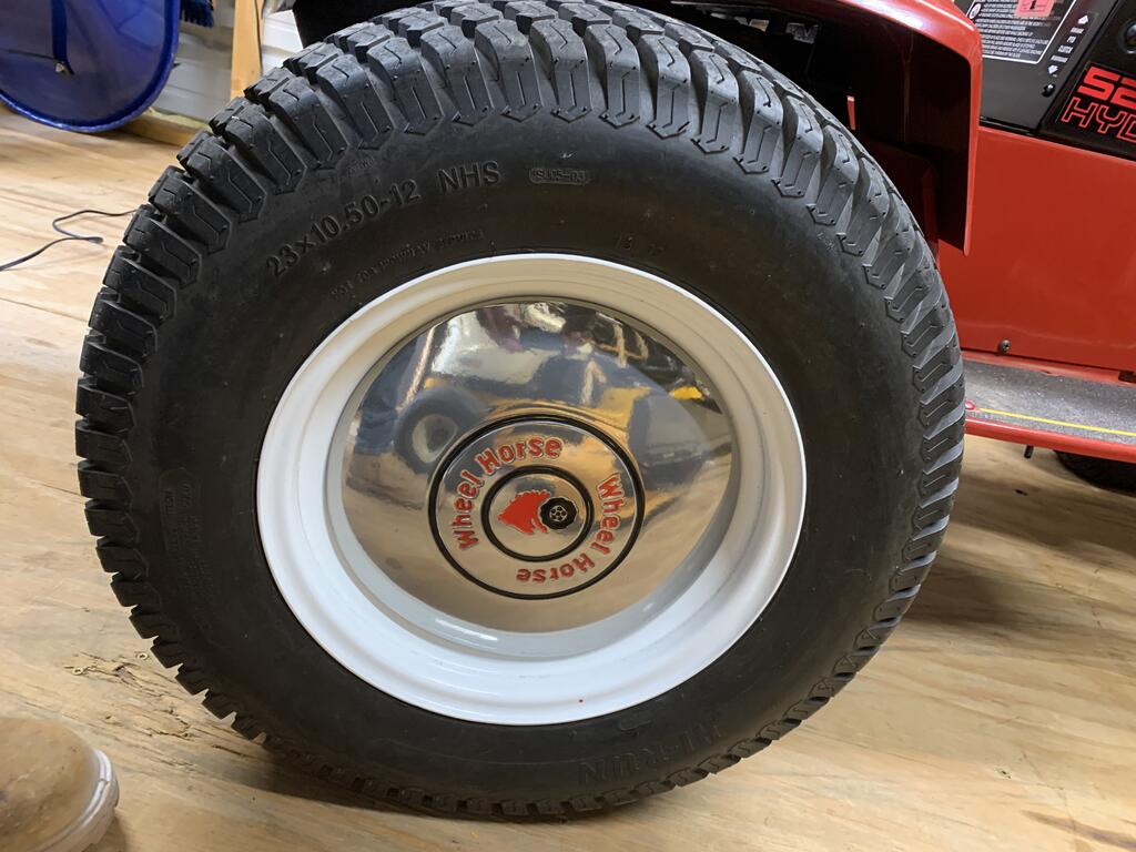

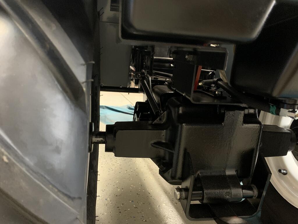

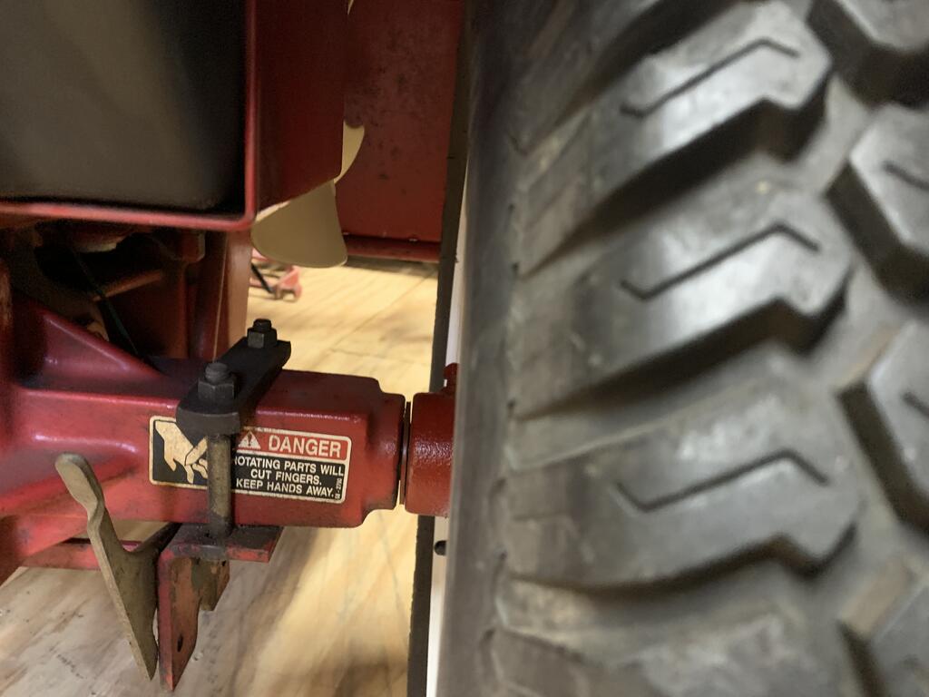

Horse Newbie 7,405 #33 Posted March 29, 2022 (edited) On 3/15/2022 at 9:25 AM, nataliator said: It has 24x12x12 rears on it with 8.5" wide wheels My 1984 Work Horse GT-1600, and my 1994 520H has 23 x 10.50 x 12 ‘s on them. The rear hubs on the 520H is next to the rear end housing and the hubs on the Work Horse are out from the housing. Sounds to me like the 12 inch wide tires may be too much… Edited March 29, 2022 by Horse Newbie 1 Share this post Link to post Share on other sites

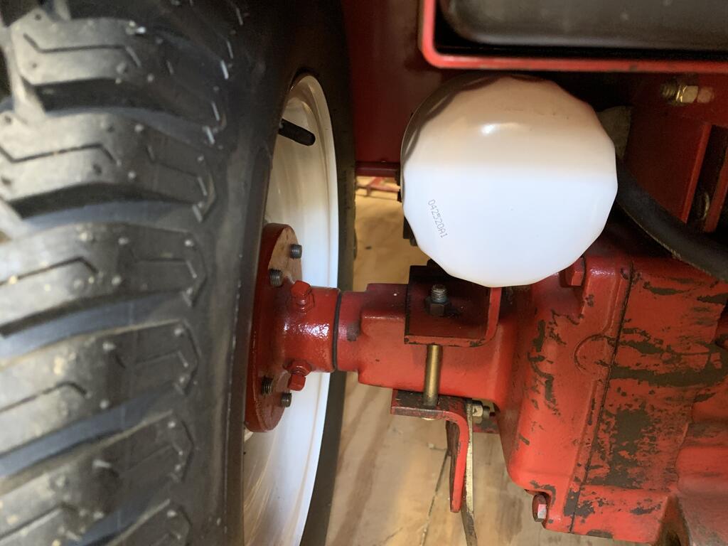

Horse Newbie 7,405 #34 Posted March 29, 2022 On 3/15/2022 at 11:30 AM, nataliator said: And another stupid question - I see a bunch of square head bolts all over the place on this thing, that kind of look like a place to grease stuff (inner side of rear hubs, for example). Are these drains for oils/grease? Or something else? You may be looking at set screws that hold on the rear hubs… my 84 Work Horse and my 94 520H have 2 on each rear hub… one that grabs to the axle, and one that grabs to the key way. 2 Share this post Link to post Share on other sites
Horse Newbie 7,405 #35 Posted March 29, 2022 On 3/15/2022 at 11:36 AM, nataliator said: I thought zerks had a little nipple on them to attach the grease gun? These are just solid top, weird... Sounds like I need to get some proper fittings for greasing it up either way If you are talking about these square heads on the inside of rear hubs, they are set screws to hold the hubs on… IMG_0295.MOV 1 1 Share this post Link to post Share on other sites
