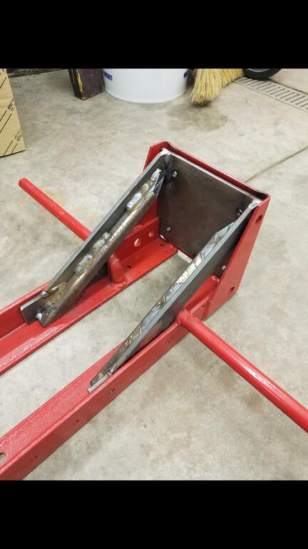

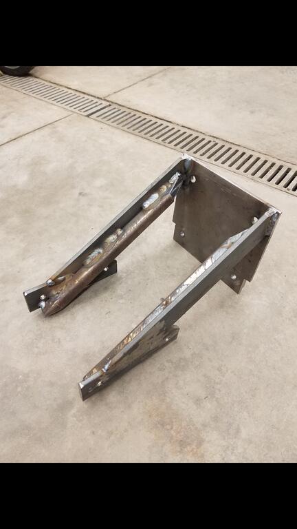

Mustang67ford 234 #27 Posted March 20, 2022 (edited) Here is my F plate reinforcement ready to be cleaned up and painted. Was going to try to also bolt to the 2 bottom holes in the side of the f plate, but dont really see any benifit. Edited March 20, 2022 by Mustang67ford 1 Share this post Link to post Share on other sites
