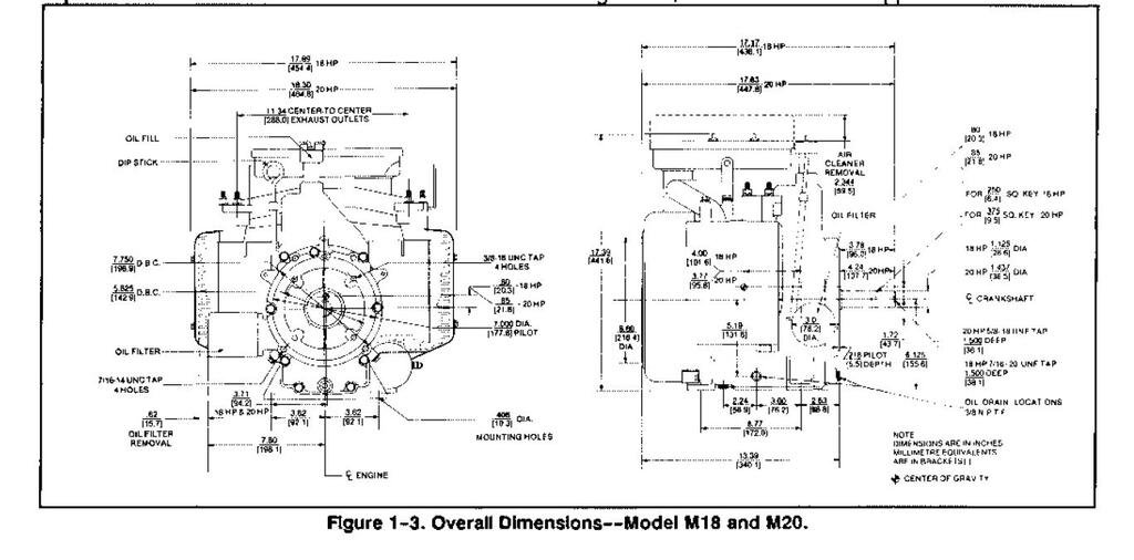

pfrederi 19,874 #2 Posted March 12, 2022 Look around i recall someone did it on a D series did away with the mid mount lift and used it for the steering... That would be a Sunstrand piston to piston but i would think an Eaton could do it. M20 is marginally bigger than a M18 but may fit 1 Share this post Link to post Share on other sites
