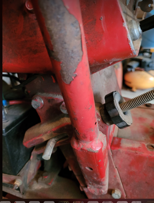

Ben444 9 #1 Posted March 7, 2022 I have a 1965 Wheel Horse 655 that I have owned for more than 40 years and I am ashamed to admit I have never really understood the purpose of this deck adjustment. I realize that it limits how far the deck can drop down, but could someone explain why it is there and give me some tips on the proper adjustment for it? Share this post Link to post Share on other sites
stevasaurus 23,857 #2 Posted March 7, 2022 That is your star wheel adjustment. With mower decks, you want the deck to go down all the way and ride firmly on it's wheels. That adjustment is more important when using the snow blade. You can then adjust the height of the blade to not scrape your drive way, like if you want the blade to ride 1/4" up from the pavement. Does that make sense?? 2 Share this post Link to post Share on other sites
dcrage 636 #3 Posted March 7, 2022 You can make ‘similar’ adjustments when the deck is attached BUT you are then screwing around with the deck/cutting blade levelness. 2 Share this post Link to post Share on other sites
clueless 3,440 #4 Posted March 8, 2022 Like Steve, said that is for adjusting other attachments heights not your deck. It should be adjusted all the way down when using the deck, many use it to adjust the deck height, but your actually changing the geometry of how the deck was designed to operate. That's right I used the word geometry here . Share this post Link to post Share on other sites
Ben444 9 #5 Posted March 8, 2022 9 minutes ago, clueless said: Like Steve, said that is for adjusting other attachments heights not your deck. It should be adjusted all the way down when using the deck, many use it to adjust the deck height, but your actually changing the geometry of how the deck was designed to operate. That's right I used the word geometry here . At least you didn't throw the calculus word out there. I've always left the deck all the way down but just bought a new deck and started wondering about that adjustment. Thanks for the reply Share this post Link to post Share on other sites
Handy Don 17,562 #6 Posted March 9, 2022 Adjustor affects any lifted attachment so mid- or rear-attached items like a grader, soil plow, tiller, or rear blade might make use of it. 1 Share this post Link to post Share on other sites
