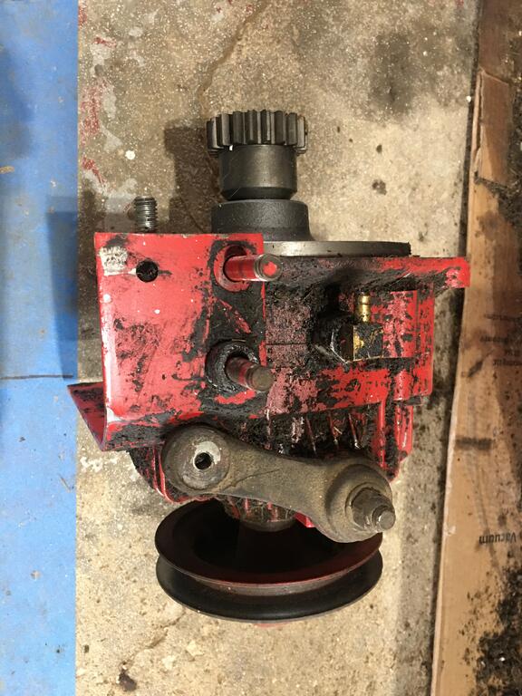

davem1111 2,377 #26 Posted April 9, 2022 Here is a picture of the old pump, not that I think that will help anything Share this post Link to post Share on other sites

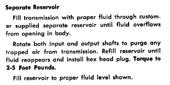

davem1111 2,377 #32 Posted April 10, 2022 10 minutes ago, Handy Don said: I'm convinced at this point that there is no, or very little, oil in there. It should roll, but NOT easily AT ALL if the hydro is connected. I agree, too, that the manual is wonky about filling it! It almost sounds like they want the bottom plug out, so that oil flows through, then turn shafts to force the air out, then plug it and top it off. I've never had a bottom plug out, so I don't know if it just drains or if you have to turn one of the shafts to move the oil for it to come out the bottom. For sure, they think that it should be filled before it is mounted on the transaxle. Your mission, should you decide to accept it, is to take it off again and see if you can get that plug out! Yeah, the second time removing/installing one of these should be easier, so maybe I'll pull it again tomorrow. I just sent an email to A-Z Tractors, and will call Monday or Tuesday if I don't get a reply by then. I looked at their website and they have a LOT of WH parts tractors. Since I'm not in a big hurry, hopefully they can pull one for me at their leisure, unless I get this one working (which I still feel is unlikely - would I have killed it anyway running it with no or little oil for a few minutes?). Share this post Link to post Share on other sites
davem1111 2,377 #33 Posted April 10, 2022 I've got the pump back off, and when I pulled it from the casing, a bunch of oil ran out onto the top of the transaxle. The pump has a small drain hole on the side with the spline gear that goes into the casing, so I assume it came out of there. I left the reservoir attached so oil wouldn't leak from the top. Tried again to remove the plastic drain plug and it is seriously in there tight. I'll probably destroy it to get it out, so I'm leaving it alone for now. This one had a regular 3/4" bolt in the smaller drain hole next to the plastic one instead of an Allen hex head (like the old pump has and the docs appear to say should be there). No biggie. I removed that bolt and slowly turned the pump over, and oil started to come out. It looked like a little water came out too. Oil looks a little "milky". Not good. I think I'll let it sit and drain for a while. Then maybe I'll turn it upside down and fill it with oil through that plug hole, then re-plug it. Putting it back on for another try isn't too daunting at this point, so I guess I'll give it one more try. Share this post Link to post Share on other sites

davem1111 2,377 #39 Posted April 17, 2022 Good news! With the pump upside-down and the reservoir on but closed, I gradually filled the pump with 10w30 Synthetic. I turned the pulley and the gear every now and then, and it would take some more oil, until it seemed full and wouldn't take any more. Re-assembled everything (well, pump, gas tank, and wheels), and fired her up. Started moving right away when I engaged the drive belt. Once I got the neutral adjustment set properly, she was moving forward and backward just fine. Put the rest back together and put the deck on. Mowed a small bit of yard, trans working great! Now I need to fix a problem with the deck height setting that seems to be even worse now. The handle won't stay in position other than way up or all the way down. In the meantime, I bought new oil for the 416-8 trans but I can't get the hex drain plug to come out, or the square fill plug. At this point I'm guessing that I will need to remove the whole transaxle from the tractor to get it drained. I tried heating both plugs with a small torch, but don't really want to start a fire. Any ideas on this? Share this post Link to post Share on other sites
