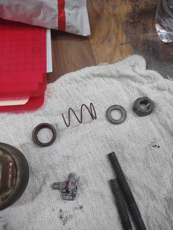

ebinmaine 75,658 #1 Posted March 6, 2022 This particular case is a Kohler KT17. Where can I buy these replacement starter Bendix springs? 1 Share this post Link to post Share on other sites

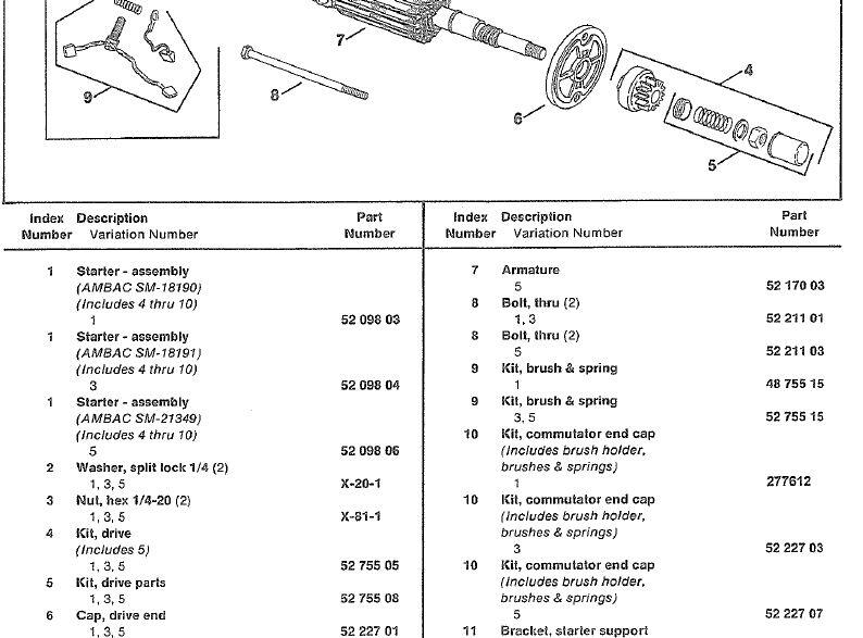

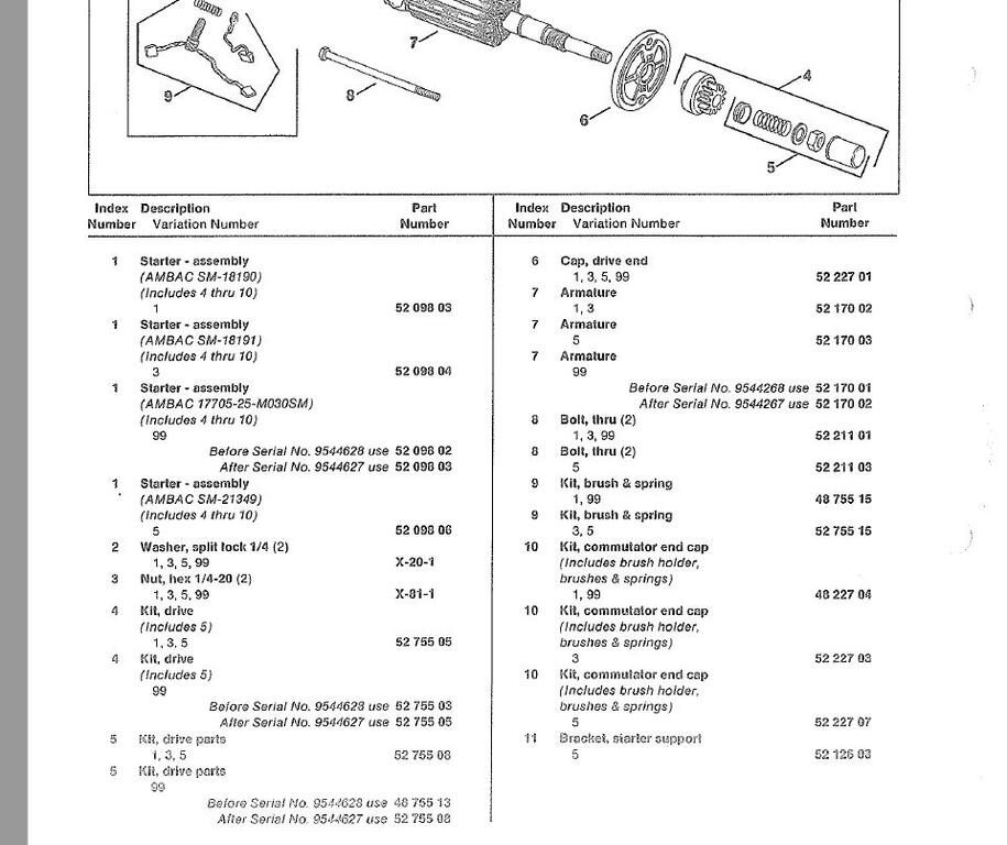

pfrederi 19,208 #9 Posted March 6, 2022 OK quick check only 1 spec number uses the odd part number (99) I would take a chance on the 5275505 (with bendix gear or 5275508 with out 1 Share this post Link to post Share on other sites
ebinmaine 75,658 #10 Posted March 6, 2022 32 minutes ago, pfrederi said: Any idea what it came from??? Oh yeah. 1986 417A. Share this post Link to post Share on other sites
pfrederi 19,208 #11 Posted March 6, 2022 2 minutes ago, ebinmaine said: Oh yeah. 1986 417A. OK forget my picture I figured it was a Series 1. if it is original to your tractor it is a series 2 Spec# 24363 1 Share this post Link to post Share on other sites
pfrederi 19,208 #12 Posted March 6, 2022 Series 2 all use same parts 1 Share this post Link to post Share on other sites
oliver2-44 11,039 #13 Posted March 6, 2022 I needed a spring for one of the starters I recently rebuilt. Took a spring from another starter and matched one up from the big spring display at the hardware store. Matched wire size, diameter and number of coils. The length was a tiny bit different. But that was just how stretched out the coils were. It works 2 Share this post Link to post Share on other sites
ri702bill 10,546 #14 Posted March 6, 2022 McMaster Carr is a GREAT source for reasonably priced compression and extension springs, without having to buy 10 or 20 like other well-known spring suppliers - they usually sell in quantities of 5 or less. Match up the OD, wire diameter, overall length, type of ends and material - shows up at your door in a day or two. Bill 1 Share this post Link to post Share on other sites
