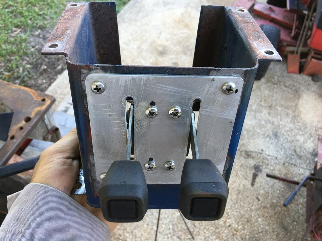

19richie66 17,929 #6 Posted March 14, 2022 I had the same problem but couldn’t find another cable set at the time. My solution. 1 Share this post Link to post Share on other sites
Dave 1953 70 #7 Posted March 14, 2022 That's a neat setup and I'm sure it works good. I am more of a purest almost to the point of being fanatical about putting them back as close as possible like they were when new unless it's something you can't see. Mine has the 27/8.50-15 ag tires on it that were on it when it was purchased new. My GT14 has never had a deck on it, it was bought purely to make garden with. My tires are all air cracked from age. I have called all over the US trying to find NOS Goodyear tires like it has and I have 1 new one in my possession that my local tire store had had it up on the shelf for decades. I know there is another one out there somewhere I just gotta find it. I love hunting obsolete NOS parts and when I find one what a rush I get man ! What are the chances of finding an old NOS Goodyear tire at your local tire dealer on the first call that nobody else has, maybe thousands to 1? Anyway, thanks for the pic.I did post some pics of it as some wanted to see what a new one looked like, they had never seen one before. Share this post Link to post Share on other sites
