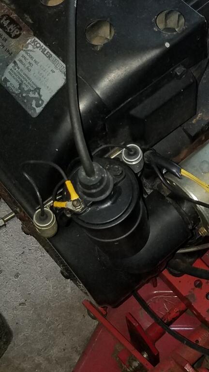

Mustang67ford 234 #1 Posted March 1, 2022 I found my K321 has 2 condensers on it. Both are connected to the + side of the coil. There is no condenser on the - side. Is this another way to hook it up as opposed to a single condenser on the - side? Share this post Link to post Share on other sites
Jeff-C175 7,207 #2 Posted March 1, 2022 (edited) 1 hour ago, Mustang67ford said: I found my K321 has 2 condensers on it. Both are connected to the + side of the coil. There is no condenser on the - side. Is this another way to hook it up as opposed to a single condenser on the - side? No, that ain't right. The condenser needs to be on the (-) side. It won't do anything on the (+) side. There are several reasons for the condenser, and one of them is to prevent excessive arcing on the points. With it on the (+) side it won't help the points at all. You probably also had a weak spark. Did it run? Well? Edited March 1, 2022 by Jeff-C175 4 Share this post Link to post Share on other sites
Mustang67ford 234 #3 Posted March 1, 2022 (edited) 6 hours ago, Jeff-C175 said: No, that ain't right. The condenser needs to be on the (-) side. It won't do anything on the (+) side. There are several reasons for the condenser, and one of them is to prevent excessive arcing on the points. With it on the (+) side it won't help the points at all. You probably also had a weak spark. Did it run? Well? Correct, i know how it is suposed to be and purpose of the condenser. Funny thing is it runs fine and that is why I figured I would question it before I go and make changes. Edited March 1, 2022 by Mustang67ford 1 Share this post Link to post Share on other sites
ranger 1,840 #4 Posted March 1, 2022 It hasn’t been fitted with an electronic ‘trigger’ unit in place of the points has it? Or has the coil been connected as a + ground? 1 Share this post Link to post Share on other sites
Mustang67ford 234 #5 Posted March 1, 2022 10 minutes ago, ranger said: It hasn’t been fitted with an electronic ‘trigger’ unit in place of the points has it? Or has the coil been connected as a + ground? Dont know. I need to open the points cover and have a look, not sure. Same thing for the coil + and -. Here is a pic as well. 1 Share this post Link to post Share on other sites

Mustang67ford 234 #9 Posted March 1, 2022 Spoke to the shop that worked on the tractor. He said the points would arc a good bit, threw a large blue arc with one condenser. He added a 2nd condencer to bring the arcing under control. I could see why the condencer didnt work if it was on the + side, but why would adding a 2nd one resolve it if still on the + side. He said its been this way for 10+ years. Still not sure what is going on unless the coil was changed and condensers were improperly reconnected. Will be looking into it further. Share this post Link to post Share on other sites
JoeM 9,621 #10 Posted March 1, 2022 Not to sure either + or - connected condenser would make to much difference. It would still be in the circuit that needs to have the energy collected as the field collapses. Two condensers would absorb more energy. Share this post Link to post Share on other sites
Mustang67ford 234 #11 Posted March 1, 2022 (edited) Determined the 2 condensers are indeed connected to the negative side. Edited March 1, 2022 by Mustang67ford Share this post Link to post Share on other sites
