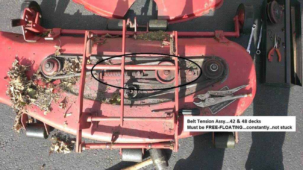

briankd 819 #1 Posted February 26, 2022 anyone have a picture of where and how the belt tensioner spring attaches ? tore mine apart couple year ago and now getting it painted and forgot how this spring attaches Share this post Link to post Share on other sites

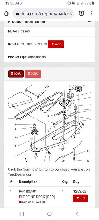

Cee245 827 #2 Posted February 26, 2022 Not sure of what year tractor or deck your working on but, Try going to toro.com and search for the parts diagram. I have a 90's 48" SD deck and its model # is 78360. Your's is probably the same. Share this post Link to post Share on other sites
Cee245 827 #3 Posted February 26, 2022 Here is a screen shot of what i just looked up.... Share this post Link to post Share on other sites
daveoman1966 3,839 #4 Posted February 26, 2022 This is a 42" deck...but the spring hooks up the same as the 48" deck. 3 Share this post Link to post Share on other sites
briankd 819 #5 Posted February 27, 2022 On 2/26/2022 at 1:13 AM, daveoman1966 said: This is a 42" deck...but the spring hooks up the same as the 48" deck. thanks that helps tore this all apart 2 years ago and shoved into corner of shed now i am finally getting back to it and trying to remember how this tensioner spring went . should have took picture of it before i took it apart but in that time probably wouldn't have the pic on my phone lol Share this post Link to post Share on other sites
