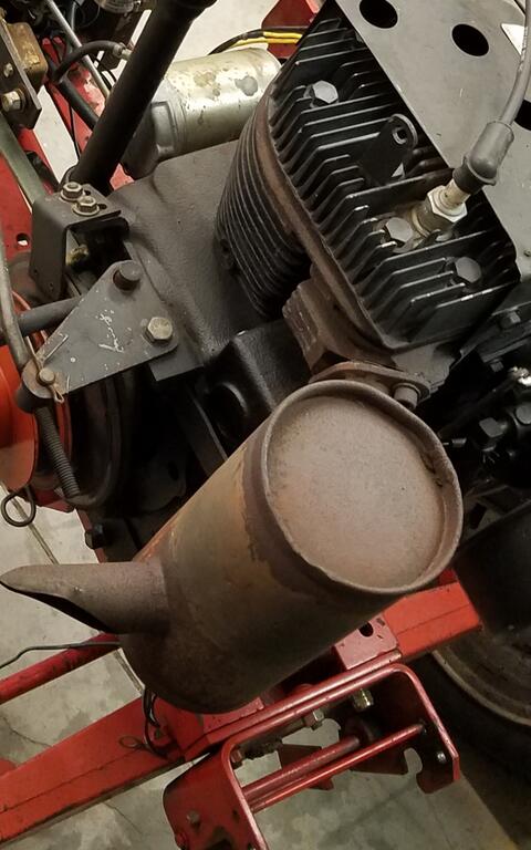

Mustang67ford 234 #1 Posted February 25, 2022 (edited) My 414-8 has the kohler k321 motor with muffer #110661. The flang is not touching the head in a couple spots, small gap. I vaguely recall that this can cause motor damage, maybe creating a hot spot on the piston? Anybody know if this is true, could be wrong. I am hesitant to remove because I can see busting the cap bolts when I try to remove this I'll have big issues. If it won't cause engine damage, then I might not touch as the noise isn't bad. Or maybe smear high temp sealer in the crack. Edited February 25, 2022 by Mustang67ford Share this post Link to post Share on other sites

RED-Z06 2,681 #5 Posted February 26, 2022 Flange probably warped from being installed with no gasket, the cap screws will usually come out, cant hurt to give en a little twist and see if they move. Will it hurt it...it will erode the metal in time and get louder, its also blowing exhaust out near the air intake, its not ideal 2 Share this post Link to post Share on other sites
oldlineman 1,577 #6 Posted February 26, 2022 A little heat on the block where the bolts go in will expand the block and draw in the penetrating oil. Patients is your friend, a little movement in one direction then the other direction, adding penetrating oil often, then maybe more heat. Bob 1 Share this post Link to post Share on other sites
pacer 3,177 #7 Posted February 26, 2022 6 minutes ago, oldlineman said: A little heat on the block where the bolts go in will expand the block and draw in the penetrating oil. Patients is your friend, a little movement in one direction then the other direction, adding penetrating oil often, then maybe more heat. Bob This is an excellent method to go at those -- move the heat around the block avoiding the bolt as much as possible adding more lubricant along and try the slight movement back and forth. As it frees up more and more it should back easily - hey, they may just back out easily anyway! Now as far as doing any 'damage' thats pretty doubtful, but a leak there would drive me nuts and I'd have to fix it! When its off clean/file/grind the 2 surfaces to make as flat as possible and add a gasket - or two! Another thought -- the block just might be threaded with 1" pipe threads and that may be a better way to go at it. 2 Share this post Link to post Share on other sites
Mustang67ford 234 #8 Posted February 26, 2022 (edited) Got the bolts out surprisingly, was sweating that one. Old muffler is off. Looks like the exhaust port is also theaded for a screw in pipe type muffer. Didn't know that and great to know if the bolts would have broke. Cleaned the threads up with a tap and ready for new. Based on the shape of the old muffler and some other dents, it looks like previous owner hit something and bent it. Should I go with new stock cap screw bolts for the new mufffler or go with hex bolts for easier future removal? Threads are standard 5/16 x 18. Edited February 26, 2022 by Mustang67ford Share this post Link to post Share on other sites
