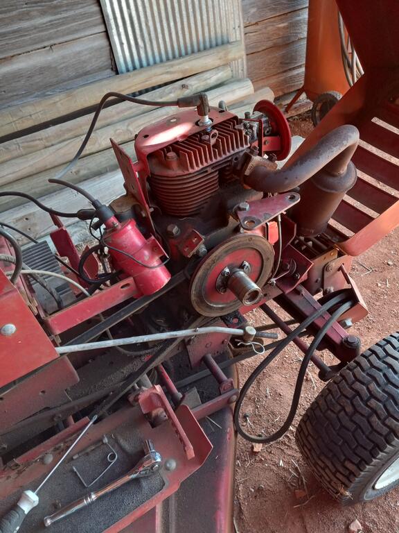

ClassicTractorProfessor 5,455 #29 Posted March 20, 2022 Well darn...pushed the C81 into the barn and out of the wind this afternoon and proceeded to pull the engine...had planned on getting it on the bench and tore down tonight, then measuring the bore and crank tomorrow after work to see if we needed to find a machine shop or if everything was still within spec order parts for it and hopefully have it running before the Pawnee show in May. Got it down in the basement and on the bench, starter was the first thing I pulled off and came to an abrupt halt...found this nasty hole hidden behind the starter...crank is shot too...guess it's time to scour the country for a replacement engine. 3 Share this post Link to post Share on other sites
SylvanLakeWH 32,467 #30 Posted March 20, 2022 Yikes! That'll do it… Share this post Link to post Share on other sites
kpinnc 18,940 #31 Posted March 21, 2022 Good news is that you're not restricted to that K181. You can go with 10, 12, 14, or 16hp if you are replacing the whole engine! C101, C121, C141, C161. Sky is the limit. Share this post Link to post Share on other sites
oliver2-44 11,735 #32 Posted March 22, 2022 @ClassicTractorProfessor I have a bare k181 blocks if you want to rebuild that one. Free to me, so free to you, but I suspect it probable need boring. I can bring it to you if we meet up at the Pawnee Ok Steam Threshers Show. If you find a different engine I would be interested in your old engine for parts. Share this post Link to post Share on other sites
