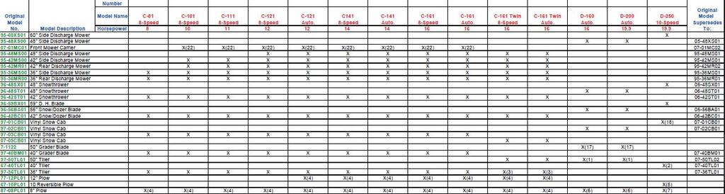

pfrederi 18,670 #6 Posted February 25, 2022 I looked at implement interchange looks like D-200 uses a 50" tiller 07-50TL But D-250 uses a 40" tiller 07-40TL01 I really do not see how they could use the same tiller. PTOs turning opposite direction and at a big difference in speed. Share this post Link to post Share on other sites
