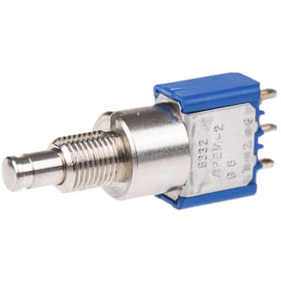

squonk 45,810 #3 Posted February 21, 2022 Joe, have you searched Allied Electronics? This is just on example of a similar switch. https://www.alliedelec.com/product/apem-components/8632a/70428596/ Share this post Link to post Share on other sites
Jeff-C175 7,207 #4 Posted February 21, 2022 1 hour ago, squonk said: similar Except for the physical size. That one is quite small! Share this post Link to post Share on other sites
