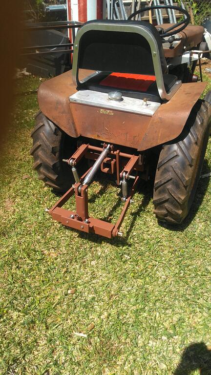

JPWH 6,541 #53 Posted April 10, 2022 I got some paint on today and mounted to the tractor. 8 Share this post Link to post Share on other sites

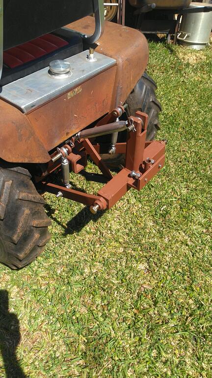

JPWH 6,541 #56 Posted April 23, 2022 I made a test run with the tandem disc today. Still have to make some pins and finish the trailer hitch. 1 10 Share this post Link to post Share on other sites

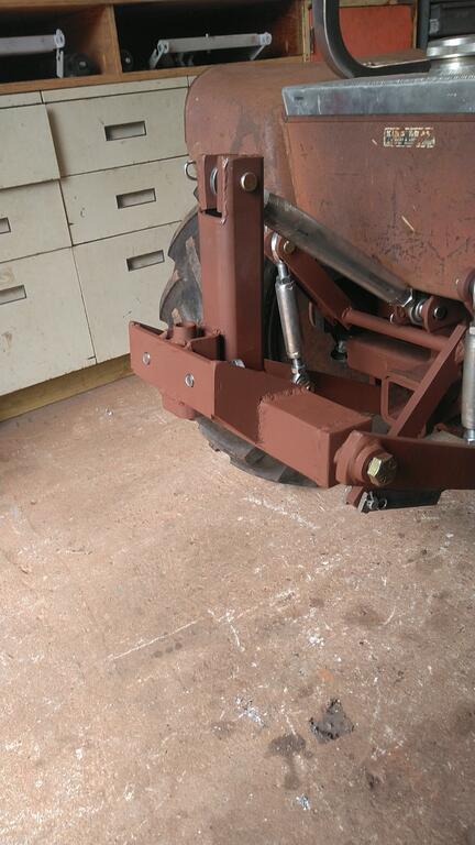

JPWH 6,541 #62 Posted April 24, 2022 Trailer hitch ready. The adapter folds down and held on the bar at the bottom of the hitch. I still need to weld the gussets below the sleeve hitch. 3 1 Share this post Link to post Share on other sites

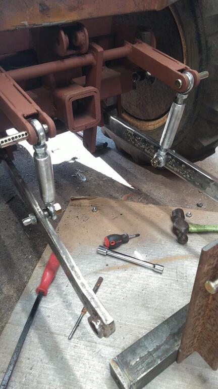

JPWH 6,541 #63 Posted April 25, 2022 My subsoiler came in today. Now I can complete the hitch build. 4 Share this post Link to post Share on other sites

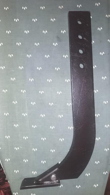

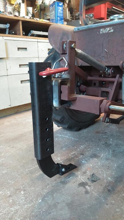

JPWH 6,541 #64 Posted April 30, 2022 Subsoiler mocked up. 6 Share this post Link to post Share on other sites
JPWH 6,541 #65 Posted April 30, 2022 I left the subsoiler on the lift while I was doing some yard work, when I came back the lift had leaked down till the subsoiler was on the floor. It has leaked down before with the heavy disc on it but not the plow or the cultivator. 3 Share this post Link to post Share on other sites

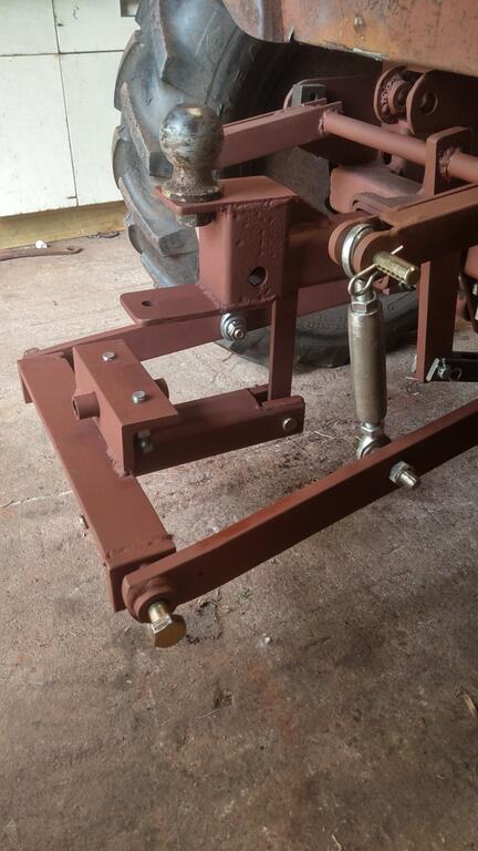

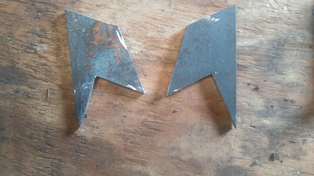

JPWH 6,541 #66 Posted April 30, 2022 I cut out the gussets for the hitch and welded them in. 5 1 Share this post Link to post Share on other sites

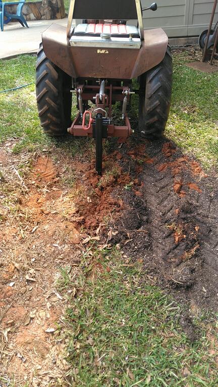

JPWH 6,541 #67 Posted May 1, 2022 I finished welding up the subsoiler, gave it a coat of paint and tried it out. The spot I tested it in was very dry and hard but it did very well. 5 4 Share this post Link to post Share on other sites

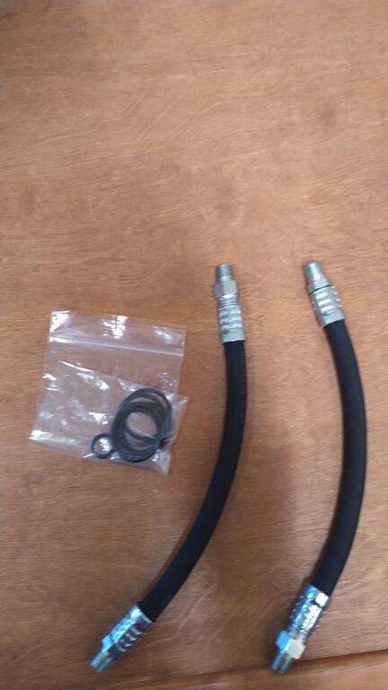

JPWH 6,541 #68 Posted May 2, 2022 On 4/30/2022 at 11:06 AM, JPWH said: when I came back the lift had leaked down till the subsoiler was on the floor. Lowell recommended a cylinder rebuild so I ordered the kit and new hoses since I will have them half way apart anyway. 3 Share this post Link to post Share on other sites

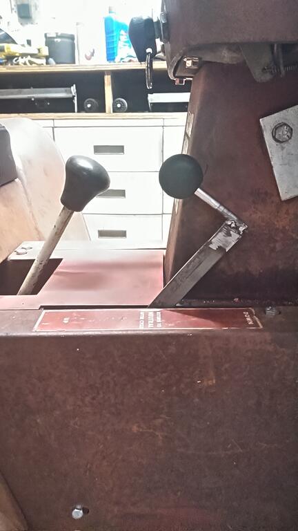

JPWH 6,541 #69 Posted May 8, 2022 I rebuilt the hydraulic cylinder and happy to report no more leak down over night. I also replaced the lift lever I had made and modified so it is easier to operate the lift while looking over my right shoulder. The way I have it set up forward lifts and back lowers the lift 6 Share this post Link to post Share on other sites
