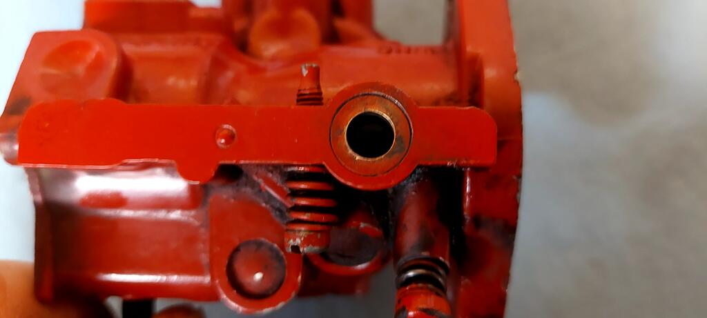

dmoore 1,023 #1 Posted February 20, 2022 I have discovered a little more side to side play in my throttle shaft on my Walbro 12 HP Kohler than should be. This may be the cause of slightly irregular idle at times. At WOT it has no effect. Does Kohler make a bushing repair kit for this? Thanks! Share this post Link to post Share on other sites
oliver2-44 11,214 #2 Posted February 20, 2022 Kohler bushing 2515802-5 NLA, you can check Evilbay but I have not seen one there in a good while. What most of us use is a Hillman bronze bushing 58087 found in those gray drawers at your hardware store. It goes in the top recess that was originally for a felt seal. Sometimes I can stack 2 of them, sometimes only one. If it is a little tight on the shaft take a drill bit and with just your fingers turn the bit to ream it out. 3 1 Share this post Link to post Share on other sites

dmoore 1,023 #8 Posted February 20, 2022 (edited) Well I was 50% successful...ha! Edited February 20, 2022 by dmoore Share this post Link to post Share on other sites
dmoore 1,023 #9 Posted February 20, 2022 (edited) As for the play there is a bushing already installed. I guess it's factory? I can't remember installing one in this carb. So at this point I don't know if I have a worn shaft or bushing or both? Edited February 20, 2022 by dmoore Share this post Link to post Share on other sites
ranger 1,840 #10 Posted February 21, 2022 14 hours ago, dmoore said: Well I was 50% successful...ha! If the shaft itself is worn and you cant find another, clean it well where it’s worn and tin it with plumbers solder to build it back up, sand it, or machine it to size. You could also try ‘JB’ Weld, instead of solder. When you remove the remains of the sheared off screw, screw it ‘In’ to remove, rather than trying to screw it ‘Out’, it will probably be easier. 1 Share this post Link to post Share on other sites
