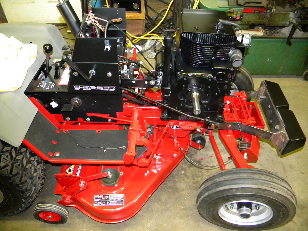

jeepdan 337 #26 Posted July 18, 2022 (edited) Engine block back from my favorite engine builder/ machine shop. He bored the cylinder .020" over and did a valve job. So, I got the block scrubbed up with soapy hot water, then started the reassembly with OEM Kohler parts. New std. connecting rod, .020"+ piston/rings, governor gear, crank bearings. And a new Kohler OEM ignition coil since the mice ruined the old one. I'm tossing the balance gears in trash. Edited July 18, 2022 by jeepdan 7 Share this post Link to post Share on other sites
jeepdan 337 #27 Posted July 19, 2022 Engine back in place. Plus, a preview pic of the front weight bracket. 1 4 Share this post Link to post Share on other sites

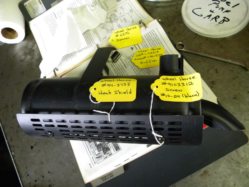

jeepdan 337 #28 Posted July 19, 2022 (edited) Along with an NOS exhaust elbow, I was able to get this complete NOS muffler assembly off of ebay about four years ago. Edited July 19, 2022 by jeepdan 2 2 Share this post Link to post Share on other sites

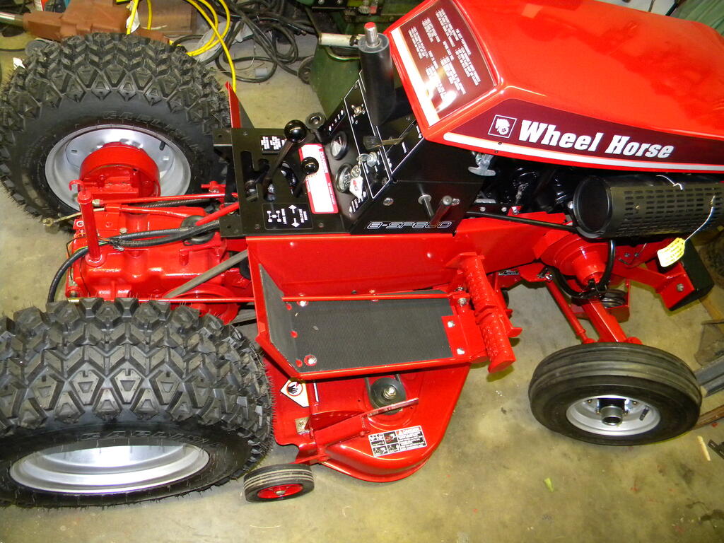

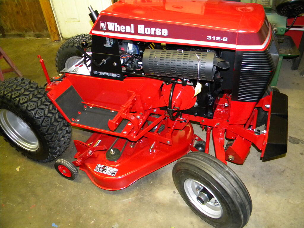

jeepdan 337 #29 Posted August 1, 2022 Been spending a lot of time in the garage, and it's coming along well. Thank again Brian Badman, and a few others for supplying me with the much, needed parts. 6 Share this post Link to post Share on other sites
Moparfanforever 926 #31 Posted August 1, 2022 Your tractor looks killer !! Excellent job !! 👍👍👍👍👍 1 Share this post Link to post Share on other sites
Heatingman 977 #33 Posted August 1, 2022 2 hours ago, Moparfanforever said: Your tractor looks killer !! Excellent job !! 👍👍👍👍👍 Like a damn showroom. When I saw the underside of the mower deck, I thought he must have spend alot of time with body filler and sanding, then I realized it was all new parts…lol. Whole thing turned out really well. 3 Share this post Link to post Share on other sites

davem1111 2,274 #35 Posted November 9, 2022 So much good stuff in this thread! Among other things, I am loving that front bumper. Was that something you fabricated yourself? I may need to make one of those - very tired of dinging the front of the hood on stuff. I'm also trying to get my daughter's boyfriend to make me some headlight bezels with his 3-D printer, since I've cracked several of those and they go for at least $20 each, for a piece of plastic. Yikes! Share this post Link to post Share on other sites
jeepdan 337 #36 Posted November 10, 2022 On 11/8/2022 at 8:44 PM, davem1111 said: So much good stuff in this thread! Among other things, I am loving that front bumper. Was that something you fabricated yourself? I may need to make one of those - very tired of dinging the front of the hood on stuff. I'm also trying to get my daughter's boyfriend to make me some headlight bezels with his 3-D printer, since I've cracked several of those and they go for at least $20 each, for a piece of plastic. Yikes! Thanks, Yes, I fabricated the bumper/weight bracket myself. I needed a front weight to help with the tiller on the back. Plus, I wanted some protection for the NOS hood. My 312-8 was only a year old, when my wife wrecked it into the corner of a concrete wall while turning the tractor around in the garage. Busted one of the headlight bezels out along with the headlight bulb. They say the first scratch is the hardest to accept on a new vehicle. 1 1 Share this post Link to post Share on other sites

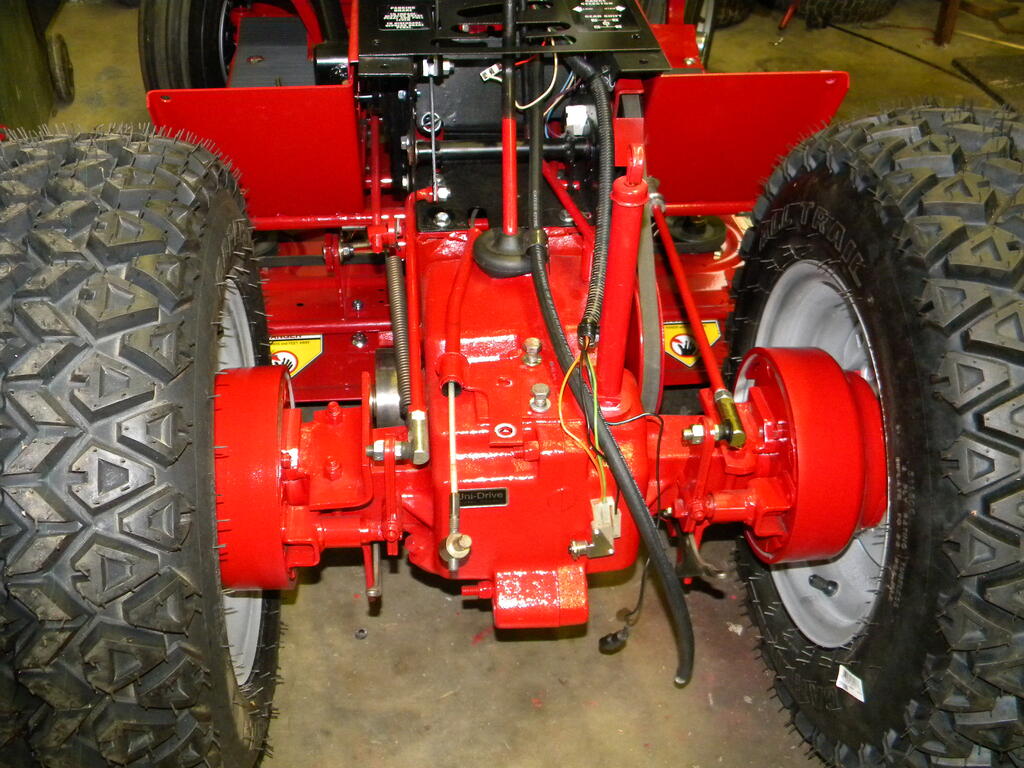

Bill D 2,729 #39 Posted November 11, 2022 (edited) Nice work!! I'd like to know more about those brakes. Did I miss the thread about the brake upgrade? Edited November 11, 2022 by Bill D 1 Share this post Link to post Share on other sites
ebinmaine 78,188 #40 Posted November 11, 2022 4 minutes ago, Bill D said: Nice work!! I'd like to know more about those brakes. Did I the thread about the brake upgrade? Agreed. @Oldskool and I have talked about a set he did on his "Hiram" tractor as well. It would be great if an upgrade was readily available for the masses. 2 Share this post Link to post Share on other sites
peter lena 9,846 #41 Posted November 11, 2022 @jeepdan like the steering rod ends on the lever rods , been doing for years with similar , heim joints , eliminates sloppy play , detailing is terrific , thank you for the photo tour , pete 1 1 Share this post Link to post Share on other sites
peter lena 9,846 #42 Posted November 11, 2022 @jeepdan have them on clutch linkage , pto lever rod , plow lever rod , totally eliminates sloppy play , steering rods , have not had a failure yet . usually change out a chronic problem area , you know what doesn't work , why not eliminate it ? pete 1 1 Share this post Link to post Share on other sites
