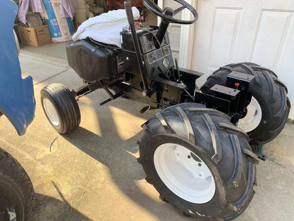

Horse Newbie 7,398 #10 Posted February 20, 2022 54 minutes ago, littleredrider said: FYI Ag's don't tear up the lawn nearly as much as you think. Turf's will more than Ag's, because they spin from lack of traction. Well I’m getting ready to find out… got my first set of ags for the Work Horse… Share this post Link to post Share on other sites
